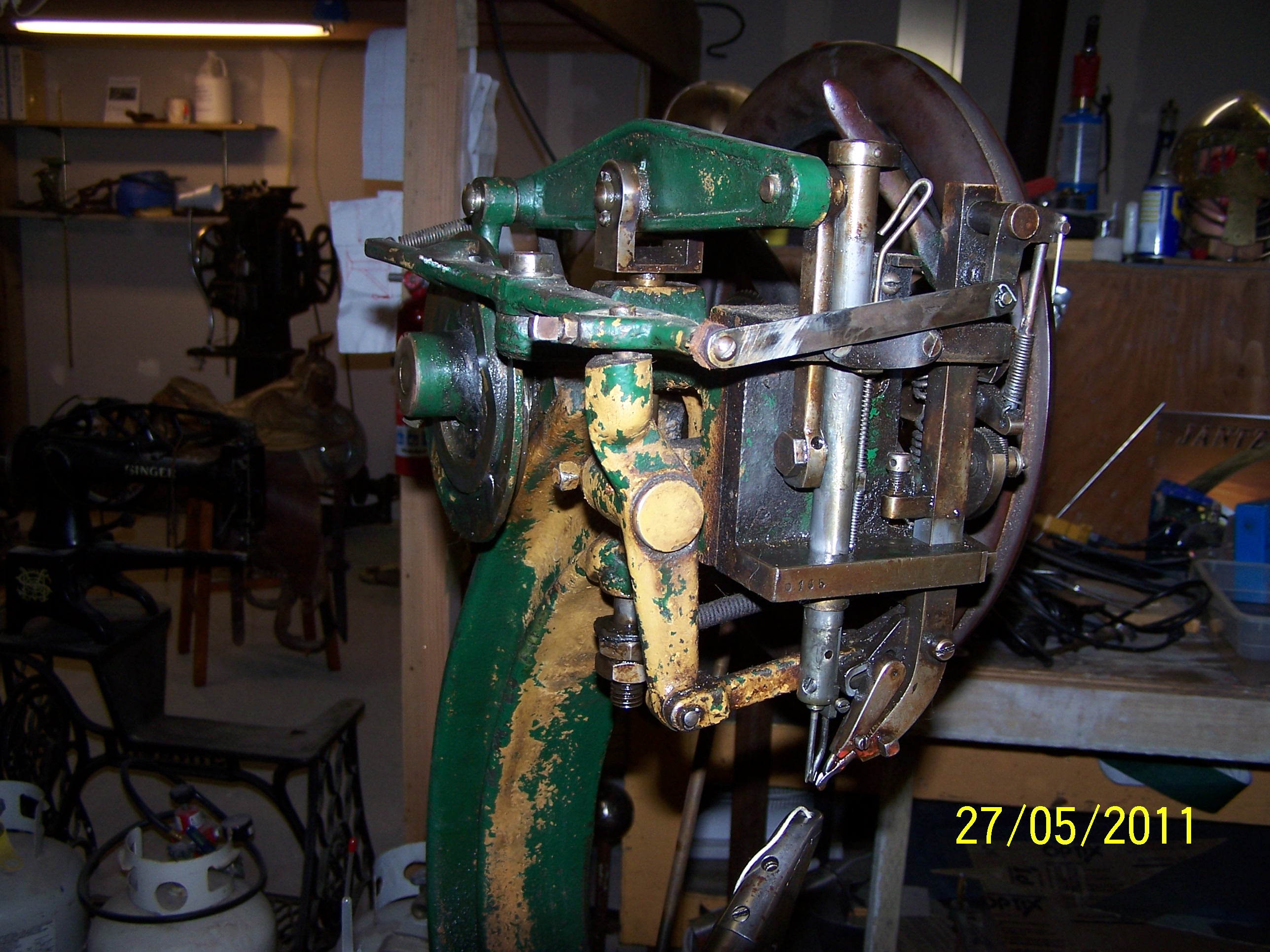

  3. OK so it is a McKay or a Blake like someone else suggested? Do you know where I might find more information about it? I can't get it to let go of first loop before grabbing next one.
  4. So is a blake stitcher all that different than McKay or are they basically the same thing? It looks almost the same as one in a Champion McKay manual I have. The cast off mechanics looks a bit different but seems to do the same thing as far as I can tell. But I still can't get it to work just right.
  5. The only thing on them is the Denby Bros plate. I'm trying to find out myself, because it looks like something is missing or bent. I'm not sure cause it's not exactly like the ones in my Champion manual.
  6. McKay style stitcher that looks like there might be some damaged/missing parts for the cast off, but I haven't been able to find a pic of an identical one for comparison. The former owners grandson seemed to think it worked but not entirely sure. The only markings on it are "Manufactured for Denby Bros. & Co. Vancouver B.C." I have a manual for a champion 77 and it's close but not exact.... or maybe there is more missing than I think. Anyway, I can get it to start stitching but it won't let go of the first loop before grabbing the next. It has been inactive for many years but seemed to operate fairly well (for what is there) after we cleaned the grime off and oiled it. Anyone have any ideas? I posted several more pics in my gallery. if that helps.
