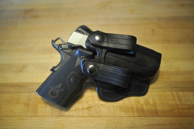

My workflow is the same. Molding comes almost last. I've made more than a few throw away holsters. I saw your J-Frame holster. Very nice. I made my first small frame revolver holster a few months back. Not sure how I managed it, but I got that one right on the first try too. I'm either getting lucky or good. Not sure which. I know it's a bit off topic for this thread and I hope no one's offended, but here's a photo of that one. As for the notch, I probably won't include it on all the 1911 holsters. Just as requested. Interesting thought though. I know I would get faster at it but it does take more time to do than the standard version. I suppose I could just charge more on all of them but a gun with no laser grips looks cleaner in my standard version (I think). -

Alright folks, here's what I came up with. As far as I can tell, it seems to be the best solution. It took a little figuring to get the notch to line up and take into account the height of the sight channel in the pattern. The customer loved it so I guess that counts as a success. Thanks for all your input. Let me know what you think. -
