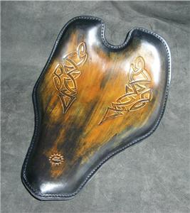

About memper

    New Member

  4. ok. Thanks. Do I need to case the leather before dyeing? Would the use of a sponge or an old ruined paintbrush get the streaking effect? To me the effect in my picture looks like wood grain. Perhaps there is a "wood grain" technique yall know about? ALso, you mention mixing half dye and half alcohol. Doesn't Fiebings have premixed ready to use jars? Im looking to order Fiebings spirit based Tan and Dark Brown
