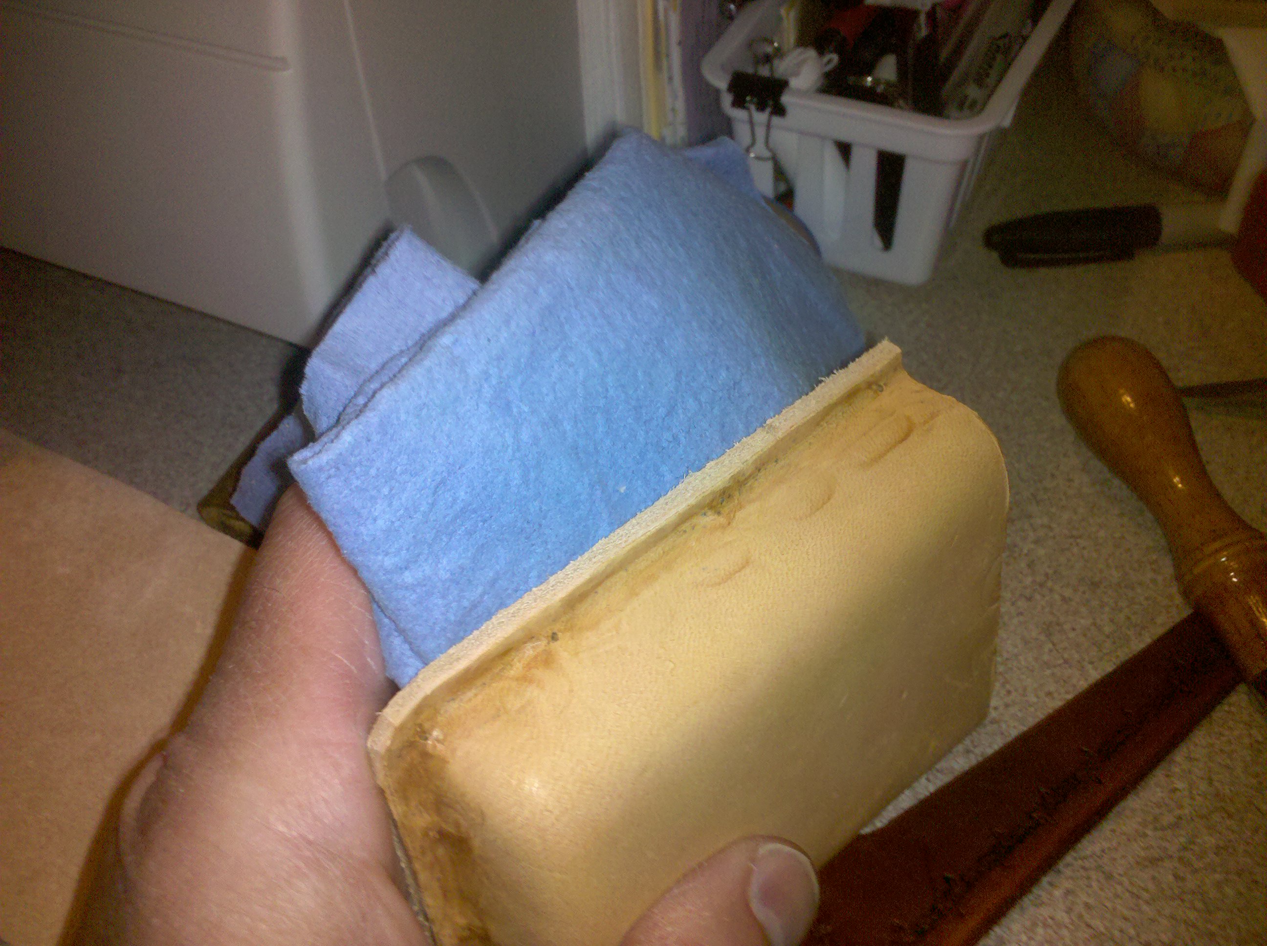

  9. Well, I did my first wet forming (or whatever the correct term is). After the leather dried, tool marks were visible on the leather. I'm I stuck with these marks or is there some way to remove them? BTW, in the pic you are looking at half my work bench. Welcome to leatherworking and 5th wheel living
