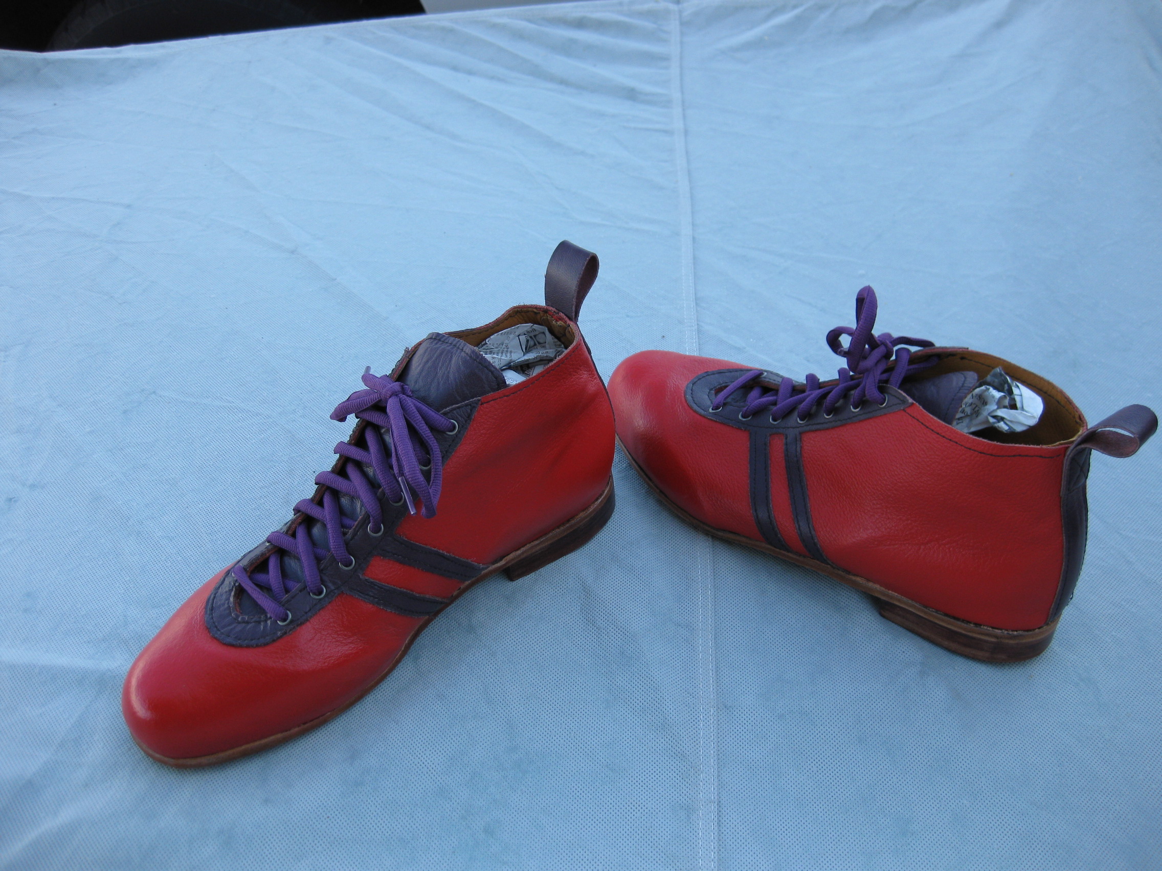

  1. Hi and welcome to the boards! I too am a noob and here is what I have found. Wiz is right, it really depends on what you are going to sew as to what machine you need. The Boss is a good machine in the right application, like a mobile Saddle maker. I have a Consew 118 Walking foot that does 2 layers of 3-4oz leather really nice, but will also do 2 layers of 8oz belt leather which is probably a bit much for the machine but it does it. I have a Singer 94-10 that was designed for curtains and it too does a great job on leather but I have modified my table with a reduces so it has more torque. Sailrite sells a nice portable walking foot machine for around 800 but I would not put it into any heavy production enviroment, for home it would be great. Look around, especially craigslist as I have found many good deals. I made my first pair of leather boots on a home machine, it is a Singer 15-91 I had to modify it of course but any thing is possible. Good luck!

  8. They Fit really good, a bit tight but that's what I was going for. I know an Orthopedic guy in Santa Fe, he sold me the lasts and measured my feet so all is well. Thanks for the reply!
  9. I have 2 pairs of commercially made boots that are the same way and they don't show any wear after 3 years. I thought about rolling the edge but figured if it aint broke dont fix it?
  10. Thanks for the kind words, I made one boot by myself as a proof of concept to show myself I can do it. Then I came up with the purple trim combo. People have been making shoes for hundreds of years so I thought why not? I appreciate the tips and comments. Have fun, and I'll post the finished skates soon.
  11. Ok, here is my first time to share with you great folks! I am big into skating, ice, roller, inline I love it all! I am a big guy, 6'3" 280lbs and I need a sturdy shoe to support me. I was going to order custom boots from a big skate co. until i heard the price, $700+ and I though well I need a good boot, then I researched and found out they use a cardboard mid sole! I was not happy, that much money and crappy materials? so I said I'll make my own. And thanks to a lot of people who helped me out, here is my creation! By the way, my investment is just over $1600 on this pair inc. machines, but the next pair will only be around $60 in materials! HAAHHA! I love this site! Jonathan
