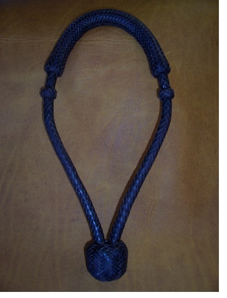

  10. This is my first go at a bosal...not perfect, but its a start... My old mare was happy to model...
