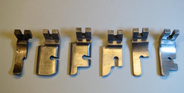

Gentlemen, some time ago I got some good advice on selecting a motor for my Claes 214-1, an Adler 108-5 clone. (This thread: http://leatherworker.net/forum/index.php?showtopic=59603&hl= ) . For anyone interested, I ended up buying a Jack KJ561A , and a speed reducer from Sieck . The speed reducer came to a very good price with European shipping, but unfortunately with a very long delivery time, still waiting. In the meantime I am trying to learn a bit more about the machine, as I know very little about sewing machines. This machine came with six different feet. The foot on the left in the picture was attached when I got it, and it was used by a sail maker. I would be very grateful for advise about the intended use of the different feet, and also for the different guides. Thanks, Arvid
Sent you a PM Arvid
