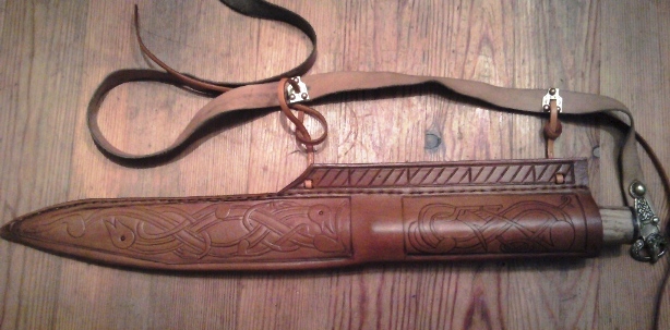

  4. Vikings? Who mentioned Vikings? I'm interested in early Anglo Saxon, Migration period and the pre-Viking era Vendel/Valsgarde culture. Vikings are 'Johhny-Come-Latelys' as far as Im concerned. There are plenty of knife and seax sheath remains to study but not many of them reveal the way in which the sheath was suspended, often because the leather finds are from ancient refuse dumps where they were discarded after having the metal components stripped from them. Some (like the 'Ford Laverstock seax which was found in a burial) still have buckles mounted on the top of the sheath which obviously connected to some hanging straps but how those straps were themselves fixed to the belt is unknown. Others have slits cut into the leather and no sign of metal components other than some reinforcing rivets to close the leather along the cutting edge. Some of these are single slits (especially on smaller knives where the sheath would hang vertically from a single thong) and some are in mutiple pairs, like the one from Groningen, which demonstrate that a pair of thongs were used to hang the sheath either horizontally or at an angle. Again, no sheath of this type has been found with fittings that prove what happened with the thongs/straps where they meet the belt (because soil condiitions tend to be good at preserving EITHER leather or metal, seldom both) but there are many examples of small metal belt fittings that have holes in them that are clearly for passing a hanging thong or strap through. So I've combined two archaeological examples to produce what I feel is an accurate method of suspension. I know it's not the only one that was used but it's the only one I can confidently reconstruct in a 6th/early 7th century context. The lower end of the thong is stitched to itself and the upper end will be secured with a couple of amber beads which are arriving today. That way I'll be able to take the sheath off the belt easily, or adjust the angle that it hangs at. Viking sheaths are a whole different subject. Small ones could be very simple (hanging from a single thong) or very complex (with multiple metal fittings and suspended from metal trichinopoly chain) and large ones had a variety of fittings and suspension methods. I recommend you look at the finds from Dublin, York and Gotland to give you an idea as to the complexity and variety of Viking knife sheaths. I can give you some links to reference material if you're really interested. A lot of re-enactors just put their knives into badly made tubes of leather that hang from a couple of loops that their belt goes through. Knives were important, a sign of being a free man or woman and even the smallest sheaths were often highly decorated (unlike sword scabbards which, contrary to what most re-enactors seem to believe, were usually undecorated).

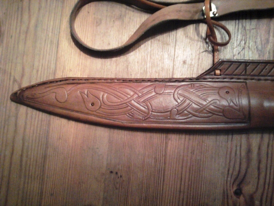

  5. Something I finished last night. It's a new sheath for my Anglo Saxon Seax. I wanted to make a new one utilising an authentic period suspension method, rather than one of the speculative methods used by most re-enactors. There's a 6th century seax sheath from Groningen that has slits in it where thonging ran through so I've copied that and combined it with the sort of belt re-inforcement plates found in 6th/7th century burials. The carved decoration is taken from pieces found in the Satffordshire Hoard.
  6. Yup. Everything you see (with the exception of the sword), I made.

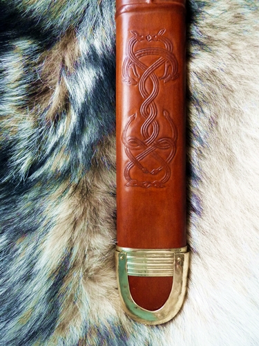

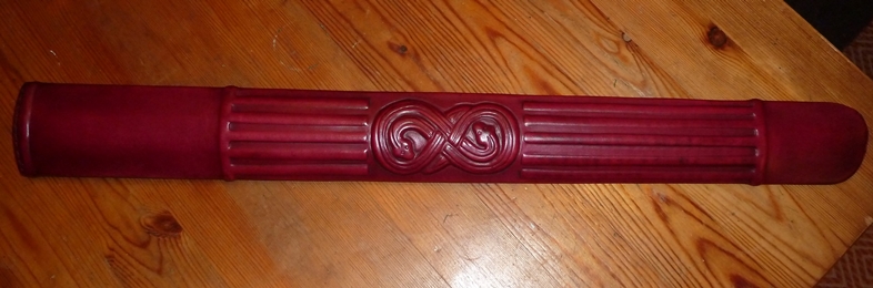

  7. Hello all, Been a member of the board for a few months but this is my first post. I mostly make sword scabbards and knife sheaths for re-enactors in the UK and Europe and thought I'd post this one that I completed this week for a customer in Sweden. The decoration on the leather and all the metalwork elements are taken from finds from the 5th century Danish bog deposits of Nydam. I'd appreciate any feedback.
