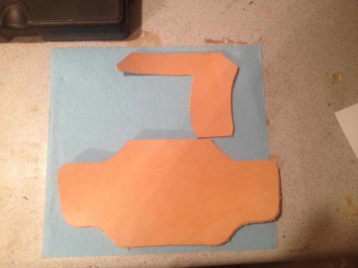

I think I understand your post. Simply cut the top piece the same length as the bottom piece, then glue and stitch. When the two pieces are folded over after they are stitched it should line up, right? Thanks, Paul
I have a question regarding the Avenger style holster I’m trying to make. I noticed that when I bend the main part of the holster over I lose some length off the top portion of the second part of the holster. I decided to add .4” to the top of the second part of the holster. Now when I bend the holster over the two pieces match up. Is adding this extra length necessary or if I don’t add the extra .4” in length will the leather stretch enough after glued to match up?
