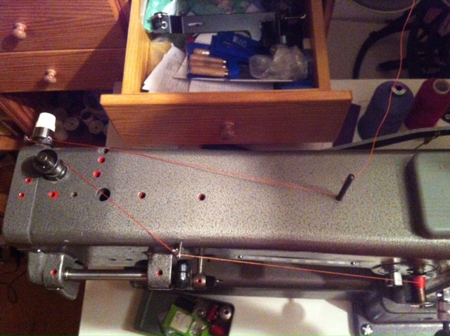

  5. I sort of cleaned the inside wheel a bit and it seems to catch a bit better. I still have problems with the thread spreading evenly over the bobbin... I know this threading probably looks really funny to some of you but it seems the only way to get the right tensioning on there Thanks again !
  6. Does somebody know how the built-in bobbin winder on the Seiko CH series works (CH8B to be specific)? I have tried a couple of different things but I don't seem to get good tensioning nor getting the thread to wind evenly around the bobbin. At the moment I use the first tensioning screw, than through the metal loop and then directly on the bobbin but it doesn't spread the thread like this and the winder doesn't turn very well.... Any help is greatly appreciated!
