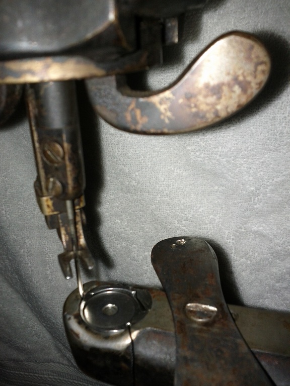

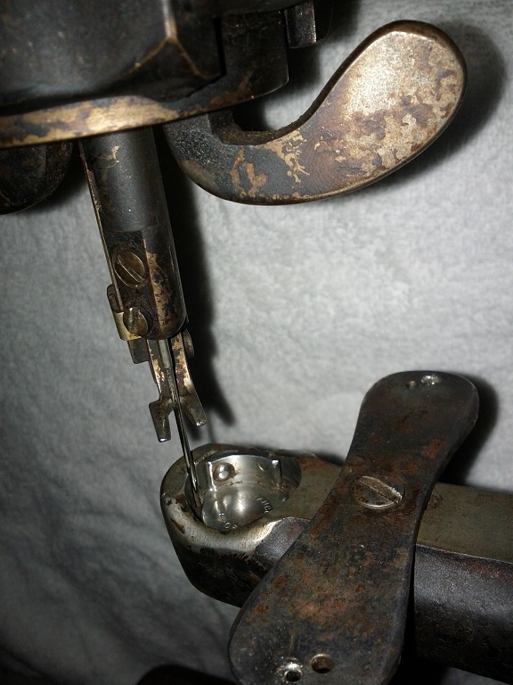

  3. Just got this champion sewing machine, oldie but a goodie. I am posting a few pics in hope that anyone that has one of these might notice any missing parts or out of alignment issues. I believe the awl is off center from the needle. If anyone has one of these guys running and sewing I appreciate any pics u can post.

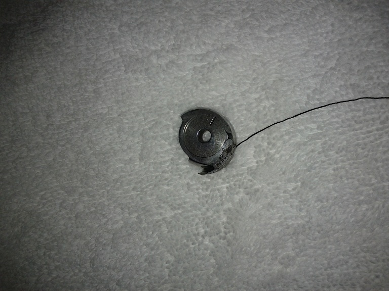

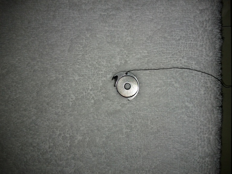

  4. Thanks for your response and taking the time to try to help. I have attached photos of the bobbin, shuttle, and needle in various positions in case I have made a mistake at any point along the way. I may be misunderstanding something basic. It's my first time using this type of machine and any and all help is greatly appreciated! The second to last photo shows a place on the top of the machine which broke off. I am unsure how much this may be contributing to the problem as it seems that the spring was designed to help vary the tension on the needle thread.
