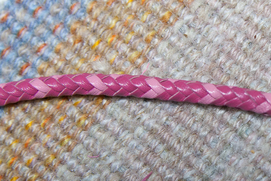

Thanks for the tips on rolling and the comments on cores and blades, entiendo! Here is pic of the finished braid (still not a finished piece). I'm kind of interested in whether I'm taking enough off when beveling (if you can tell from this shot) and/or if braiding very tightly over a core might be part of the issue.. Thanks! Pat K Juneau, AK

For some reason, the image in the middle of the post displays much smaller than the one that is under "Attached Thumbnails". Don't know why...sorry. Pat K Juneau, AK

Hi everyone, I've been lurking in this forum for a year now while I learn the craft of braiding kangaroo leather. I've read, with interest, the opinions on whether or not to bevel . I bought a beveler from YKnot Lace over a year ago but was afraid to try beveling because I was sure I would ruin a bunch of leather before I figured it out. Yesterday I got my courage up and decided to give it a try. Although I'm still in the learning curve as far as beveling goes (and also keeping the tension even on 8 strands :-), I found it was not as hard as I thought it would be. I decided to do an experiment to see the difference in quality between beveled and unbeveled. Here are the results: (The pink collar is beveled, the brown is unbeveled). You can also see that I must have missed beveling one of the light pink strands (it sort of sticks up above the rest) which I realized after I started braiding. Since this was an experiment I decided to leave it as is. I started thinking it might be interesting to try leaving a couple of the strands unbeveled on purpose to add some relief/texture as a design element on the piece. Pat K. Juneau, AK
