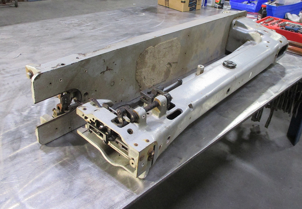

  2. Has anyone seen or operated one of these before? I picked one up off Craigslist on a whim. The main shaft is broken in two places, but I'm hoping to bring it back to life. Everything else inside seems to be ok, save for some cob webs and dust. I think it is a longer version of the Consew 206RB. I can't find much about this machine except a government liquidation auction site (where I think the person I purchased it from may have originally got it) and some overseas manufacturer profiles (not much info there re: parts or even a manual). I picked up a Consew 206RB manual hoping to get an idea of how the internal gears work. Any guidance for getting an original Emery manual or leads on replacement parts would be much appreciated!
