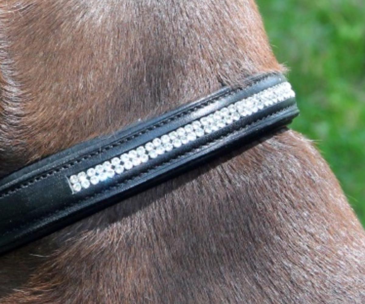

I am making dog collars. I have made a few for my friends and my own dog. They turned out nicely in my opinion as far as looks are concerned. I think I will do well with this when I get some knowledge and experience. I enjoy this very much. I am using 7-8oz veg tanned mid-grade leather.
However, the collars I have made already are under conditioned and won’t last through the years with the elements in my opinion.
I am self-learning and the people at Tandy were helpful, but not to the level I needed when I was there asking questions to purchase items. Example: The guy at Tandy told me all I needed to do was dye and then put on Aussie Conditioner with a cloth after and it was finished. So that’s all I did for my collars as far as conditioning goes.
Two of the collars I did have a little acrylic (Cova Color) on them. One to fill in a name stamp, the other was a hand painted design. Then Aussie blown in with a heat gun. But that’s it. Others have dye and then Aussie blown in. Again, that’s it.
