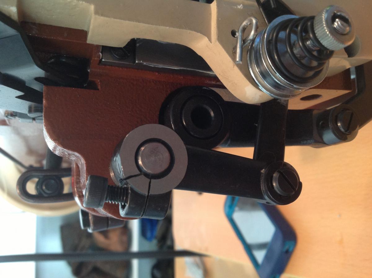

  6. Trox, After hours of looking where everything leads too, I figured it out. The part where the screw goes on the shaft that runs the outside walking foot was broke. Must have had a crack in it and as soon as I ran my first test stickers it broke. Thanks for the reply. I'll attach a photo I case I didn't explain it well.
  7. Thanks! It does not move up and down. It did for about 10 stitches while I was adjusting tension then it just stopped. Any idea why by chance?
  8. I received my new Cobra 4 yesterday. I was playing with the tension getting it set when the outside walking foot stopped moving. The inside works like it is suppose to. Being Saturday, I can't call Steve. Anyone know why it's doing this and how I can fix it? I'm extremely new to these types of machines.
