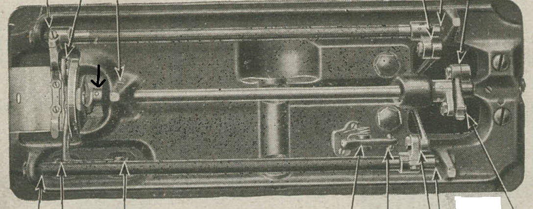

  1. The driver is removable . is very difficult beacause the space that will remain betwin neddle and hook if i bend the driver . I don't really have where to buy replecement pars for this machine in my country . I'm thinking if i bend the driver like you said , the thread it will get over easily over the bobbin ?
  2. The hook point and the needle are colse enough , the thread loop is good and the hooking its good , but it's seems to have a delay . After the hook grab the tread and take it to the ending position the thread is not retriving to get over the bobin , and is going back . I don't understand where could be the problem .
  3. I uploaded this picure to see from where i advanced the hook timing . Thank you again.
  4. I didn't succed to repair it , the thread is picking up too late , but how i can put this in order ? I have adjustet the hook from lef side , the side where is the bobbin , but no results , i dont understand where are you saying to advance the timing from right side ?
  5. I was thinking about this , but i wasn't convinced that may the problem . Thank you for the advice , i will return with results .
  6. Hi everyone , I am new on this forum , and i'm asking for you're help . I have some problems with my singer 31-15 , the underneath thread is hanging or i don't know how is possible to tangle in this way . I notice that sometie the hooked thread didn't get over the bobin , and that may be the cause of this , but i need some of your suggestion . i have attached a picture of thread. Sorry for my english.
