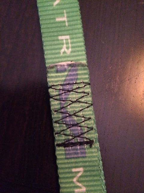

Titanium and Kevlar -- you're speaking my language! Would you say that a box x sewn (nicely) by hand VS a few straight line bar tacks would be much of a strength difference in a connection between two pieces of webbing? What would you say is the ideal thread size and type for attaching webbing? I guess that's more of a question about rigging than leather working -- but if somebody knows..?!? I have a pretty good local sewing machine mechanic guy who is helping me out -- will check to see what he has for tackers today. Picture is how local MC jacket repair lady has been sewing my proto's...have separated one of these. -

Hi, First post here and I'm dragging up an old thread -- I'm new to the sewing world (at least the DIY sewing world) and I'm thinking I need an automatic bar tacker that ideally sews the box x pattern like this one does. I'm sewing leather (1.2mm) onto poly webbing for some custom motorcycle tie down straps I'm making up. I'll need to go through 2 layers of that leather, webbing, and velcro. I'd ideally like to get a machine that can sew straight seams and also do the pattern stitches -- is this possible? I was looking at a Consew 206 RB5, but I'll be bar tacking for more than half my work...so please advise if I need to prepare myself to buy two machines or there is one good one to do it all! I really appreciate all the info in this forum --- this stuff isn't very accessible for the newbies!
