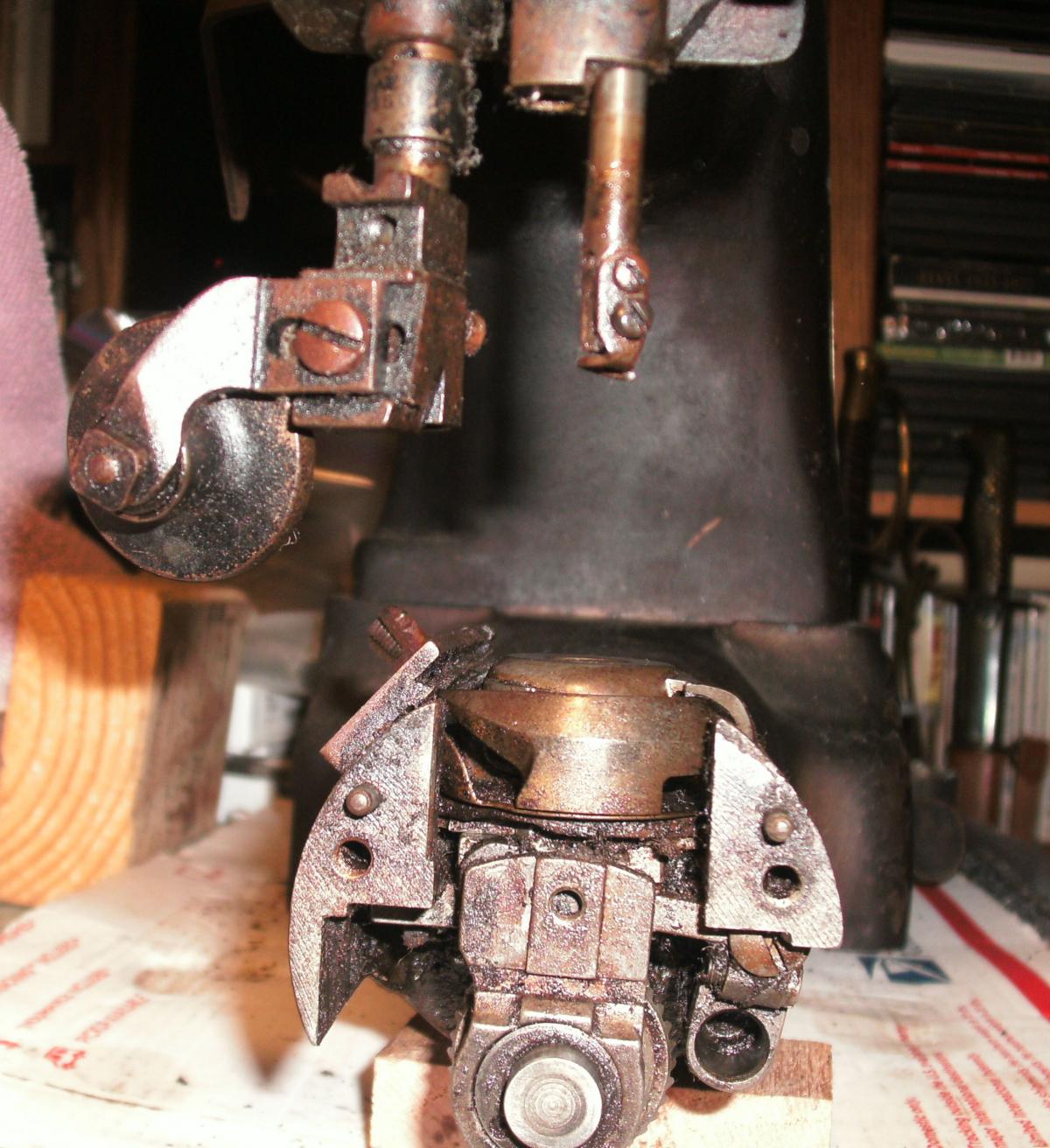

  11. I have confirmed that I need a 38 tooth belt for my 153W101. I have looked for a while and I can find no source for a 38 tooth neoprene belt. They seem to be as scarce as hens teeth! If anyone might know of a source please let me know. I also have a wheel foot on it and was considering trying to go back to the walking foot system (only needs a few parts since it has been before) but I have been told the wheel foot is very good for knife sheaves and small holsters. I also may to find a parts machine to change the sprockets for the 224195 belt. If I live long enough, I will get this machine running!!!!!

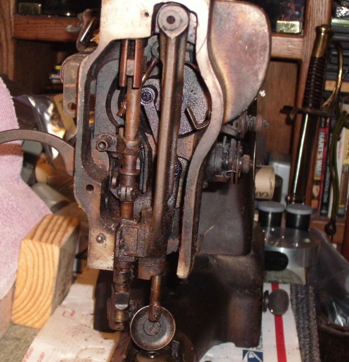

  14. The machine is dirty with a little surface rust. I have oiled and cleaned most bearing surfaces. I have a small problem with the bobbin holder but I am cleaning that area now and will see if I need parts. The reason I am fooling with this machine is that it was not hurt so much in the fire as the water to put it out. I have been working on this machine since I think I can Use it and I can't afford a better machine for my purposes. Now hand sewing is the best I can do and I have arthuritis in both hands and think I need a machine. Hang me but I have also thought about the Chinese shoe repair machine on the market now.
  15. I will try to send photos if I can figure out how! My brain is not as efficient as it once was!
