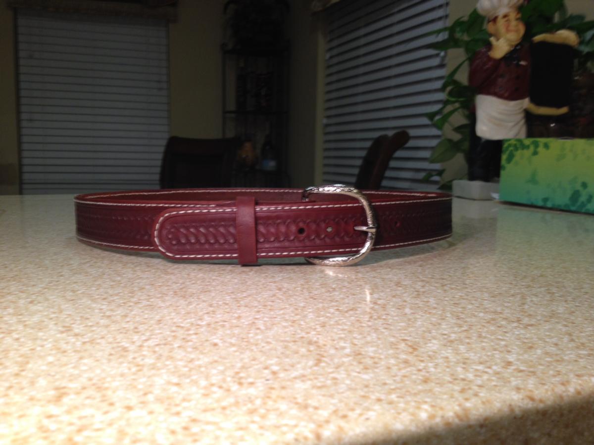

Pretty new to this craft and first time posting.......just finished a nice tooled belt. Wanted to get a fairly light brown color but wanted it to be deeply dyed due to high wear, so I added Feibings light brown to denatured alcohol and used a dauber.....soaked it really good. Seemed to have lost a lot of the crisp deatail in my tooling. So....the question is, how do you get a deeply dyed product without losing detail? It also turned out a lot darker than what I was shooting for! Thanks! Reb
