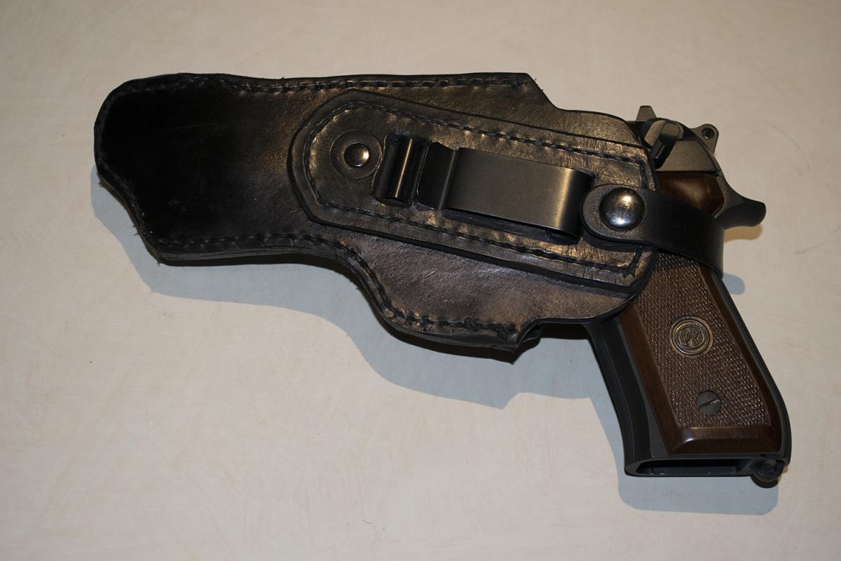

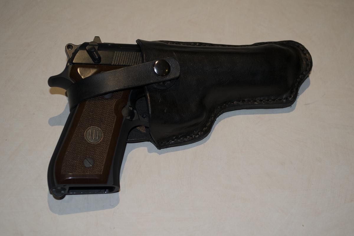

  6. First time making a holster. This is my second leather project, the first was a stacked knife sheath. I have since pulled this holster apart because the belt clip isn't strong enough. I can draw OK but it's a heavy gun and I feel like it moves around too much. I'll be doing action pistol type stuff but also carrying on hikes, so I wanted a removable retention strap. I'm happy with this part but not so much with the "patch" I used so the front snap wouldn't come in contact with the gun.. I found I need to get some thinner leather for that type of stuff, I'm using my one piece with is easily 10 oz. and the snaps require a lot of dremel-skyving to recess the seats. I could use some ideas on finishing. I'm using Fiebing's USMC black dye, three coats buffed, then Tan Kote. Every little nick and scratch shows up, and I know some of that is due to semi gloss black finish revealing that. But is there a way to finish up the leather before dyeing? I don't like the Tan Kote either, it goes on very splotchy and uneven and doesn't take to being rubbed in. Any thoughts on an alternate?
