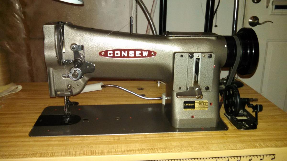

I put the speed reducer and a 2" (clutch) motor pulley on it from my 111w and it is sewing like a dream. Goes as slow as I need and as fast also. I am really liking having Reverse for the first time
Henrye & Colt: I figured someone on here would know what the dots were for, thank you. Chavez: I think it was a good deal for $475, and yes it looks brand new. I think it has been sitting in this lady's garage for the past 18 years and not being used. She claimed to only use it a couple times. I don't know what a "couple " means, but it definitely did not see much use. My guess is it was more than she could handle.
I don't know, I will have to check that later when I get home. I haven't had any issues with removing the bobbin but did not notice the alignment of the marks.
I recently purchased this 206RB-2 and got a great price because it would not sew properly. Missed stitches and or it would not pick up the bobbin thread at all. The machine is practically new and has been stored in a garage for many years. I thought it was worth the gamble an purchased it. I went thru the manual and set the timing of the hook and needle as described and the machine is now humming along beautifully. My question is regarding the white dot on the body by the hand wheel (see picture) and the corresponding white dot on the hand wheel (not shown). I do not see any mention in the manual about them and they did not come into play in the timing procedure. Am I missing something? They must be associated with some type of timing is my guess. Any insight would be appreciated. Thank you, Bill

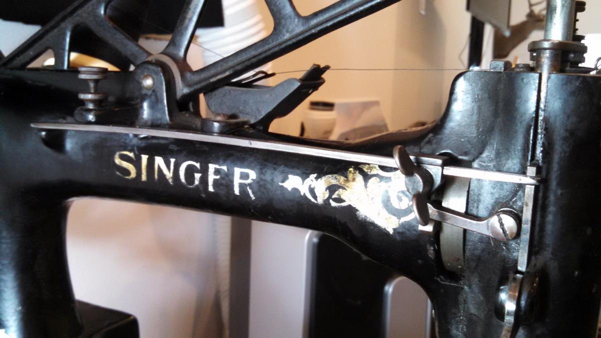

Ah, I think I found a picture of what you are describing. The piece you were talking about should be removed and turned over like in this picture, is that right? This picture is from an older machine.
Thank you. I am not quite sure what you mean. Do you have a picture?

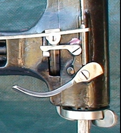

Thank you, here are the photos. One picture shows the tension bar #8627 and the ball bearing. The next picture shows the bar installed but I don't know what to do with the ball bearing? Also, I am not able to get my lower thread tension tight enough. The tension screw on the shuttle hook #8603 is turned in as far as it will go. I tried adjusting the upper tension but the stitch is too loose.
