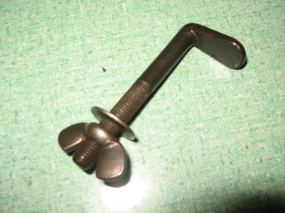

  11. Can any of you identify this part? It was in with some sewing stand parts a friend sent me.

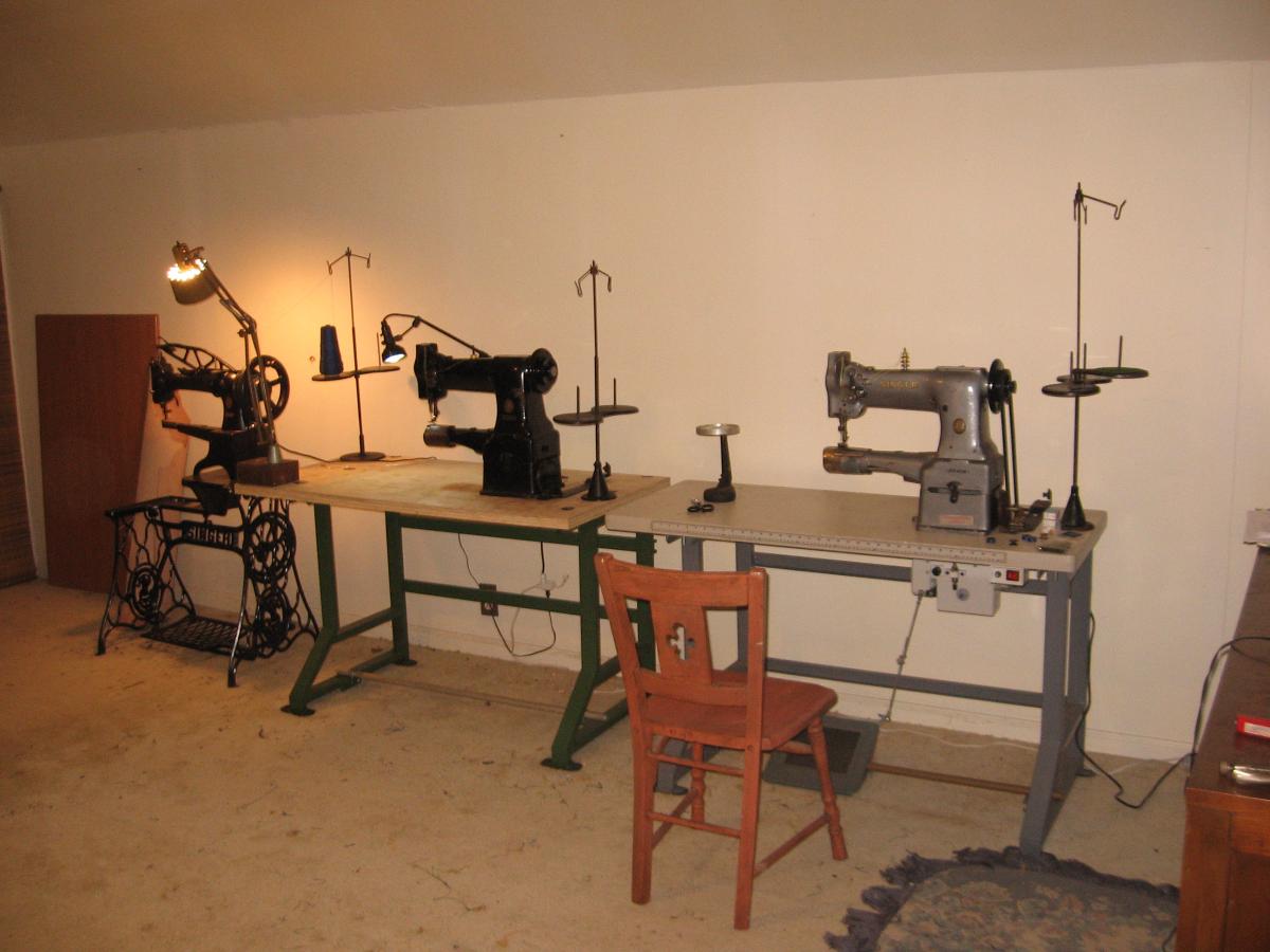

  15. Not much progress on the room itself, the carpet still needs to go but by the time I retire I'll have it like I want it. I have an out building but it isn't convenient. I want a work shop in the comfort of the house. There's plenty of room upstairs here and it's just me and my daughter who occupy a 2700 square foot house with half that area upstairs, it is a gold mine of space. I'm in the gathering phase of it all now. I don't even know what I really want to sew! I treasure the machines and I have enough of a variety of types to do most anything. I'll probably be going to the speed reducers to slow the pace down a bit. The good ones sure are expensive! Here is the latest progress on the set up. I'll be glad to see some oak flooring exposed in the future. A lot of work yet to do.

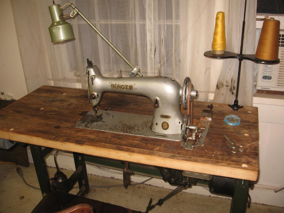

  16. Here is a picture of the 29K58. I picked it up a couple months ago. It needs a cam roller replaced that controls the stitch length. I took it apart and found a flat spot on it. Makes the walking foot a bit loose. I paid too much for it but I found it local in Atlanta so I drove 55 miles and paid premium versus driving 1000 miles for a cheaper one. It was missing a couple of hard to find screws but I managed to obtain them from College in England. The machine is slow but handy!
