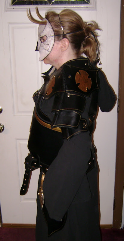

Just finished this. Like always, it's made to the customer's dimensions, and my wife-size mannequin is swimming in it.
15oz vegetable tanned leather, Fiebing's medium brown dye, Master spray shine finish. Nickel plated brass hardware and latigo strapping. The lion on the chest is a belt buckle that I ground the belt bits off of the back of, and soldered on a couple copper rivets. The design is the customer's, I'd never have made armor that closes in the back, but hey, his drawings didn't show any closures on the front or sides, sooo....

It's all minimum 12oz vegetan for the black parts. The floating joints and some of the strapping is done with some gold garment leather, maybe 4oz. Cape is a reindeer fur - there's a guy selling them on eBay for $90 shipped, which is less than I paid for one a few years ago from Moscow Hide and Fur.

Some armor I'm working on for one of my guys. Torso finished:
Obviously, he's larger than my wife, who's modeling it.
