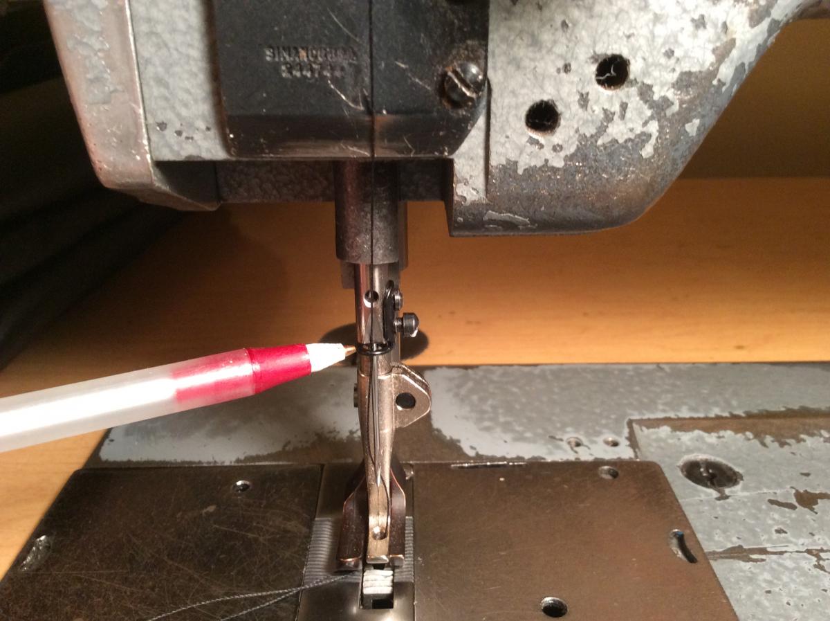

  1. Bob, The "bar Spring" (thing that activates the thread tension release) was no longer available, so I made one out of some 16g stainless steel I had in my scrap bin. Apparently the original was 18g. It needs to flex, but not bend, because the bar travels too far for hard contact between the two parts. The main "Knee Lifter Lifting Lever" I made from scratch as well. I was supposed to be 3/16" thick by 3/4" wide bar stock, but I could only find 1/4" x 3/4", so I adapted the height of the stabilizer post to accommodate it. The only parts that I ended up ordering for it were the return spring and the pivot bolt. Together they were under $20 CAD. I ordered the little screw that holds the bar spring to the main lever too, but it turns out it was a completely obscure thread pitch, and I didn't have the right tap. I didn't use it at all and ended up drilling and tapping it for a M5 x 0.8 machine screw. That's the phillips-head one you can see in the picture. I too was frustrated by the lack of linkage between the manual lifting lever and the thread tension release. You can reach through and push it up with your finger, bit it's really small and you're doing it completely blind. In a previous lifetime I sewed on several industrial Juki, Cansew, and Pfaff machines making industrial rigging equipment and backpacks. All of these machines were equipped with knee lifters, so I got very used to that technique. I definitely like being able to keep both hands on the workpiece, and only lift the foot as high as necessary to make the turn or get the work under there. Whatever you're used to really. I can almost guarantee that if you did get used to it, you'd never go back! It would be interesting to see one of these machines set up with the foot lift lever linked to the pedal. I see that in the manual and parts diagram as a possible option, but I haven't quite wrapped my head around how it would work. Apparently that is the reason for the little through-hole in the back of the base casting. K

  3. The first of these pictures is the most revealing. It shows how the little "L" shaped arm reaches inside the machine and pushes up on the mechanism to lift the foot. (Poor terminology, sorry) What I didn't realize until I built it, was how it reached right inside to lift up the foot. I had thought that it pushed up on the same little knob that the hand-lever did when lifting the foot. The other two photos are rotated 90 degrees, but I'm trying to get you a bit of a view inside to where it makes contact. Let me know if this helps, or makes things more confusing Kris
  4. The first picture shows an overview of the back of the machine. The second shows a close-up of the little bracket that activates the thread tension release. My pen is pointing to where they contact. Lifting up on that little lever on the back of your machine with your finger should spread the plates of the thread tensioner. I have to go back for more pictures. The files were too large of the other ones I got. Standby...
  5. Hi Bob, another helpful member here (Skylark53) helped me out by making a very detailed drawing of the missing parts from a friend of his who owned the same machine. I suggest asking him if he'd share the drawing with you too. His drawing appeared a bit different than what was visible in the parts diagram for the machine, but it worked out with only a tiny bit of modification. I'll try to get you a few pictures of how the mechanisms interact. K
