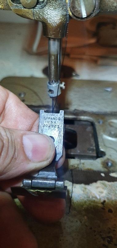

  1. hi Constabulary,... i figure that you know a lot of dürkopp 252 series.. I'm restoring a 252-4, and is have now simanco feet, and unknown needle plate and feed dog...and an original dr8ve belt yet... Brazil has a lack of old durkopp supplies.. could you suggest needle plate/feed dog alternatives and maybe, some belt supplier??? thanks
