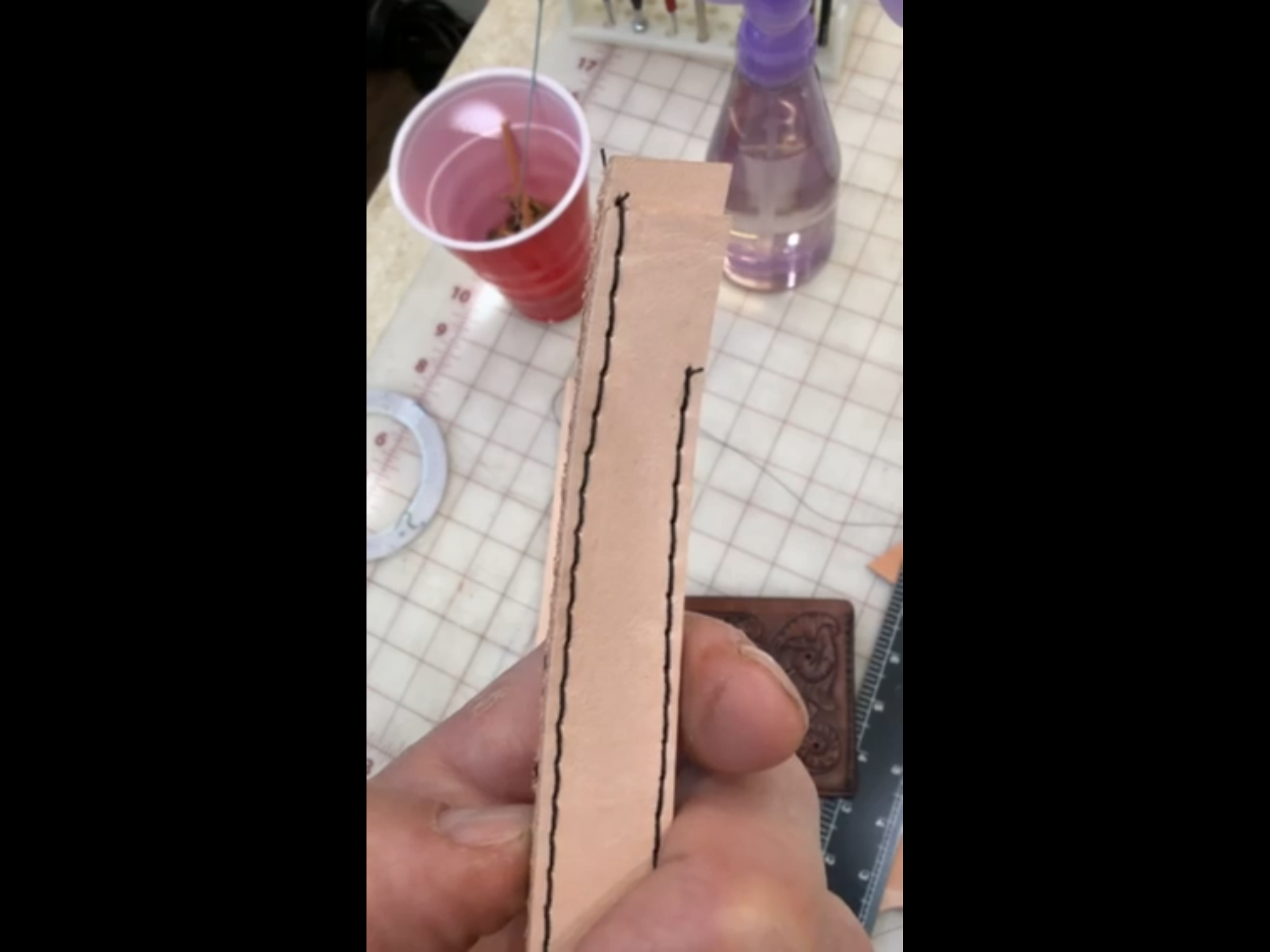

  2. I can’t figure out why I’m having problems with this new machine. Any time I try to sew near the edge of leather, I either bend a needle or the bottom of it looks awful. It wanders badly and just doesn’t like it. In a lot of cases, it will bend the needle. Even being a new needle. Yet, if I move the leather to about 1/2 in towards the throat, it works fine. So, is it the pressor foot? Or what’s going on? I have a consew 206 that I’ve been using when it’s near the edge but I’ve purchased this machine to take care of my leather work.
