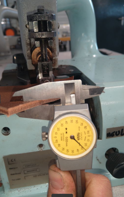

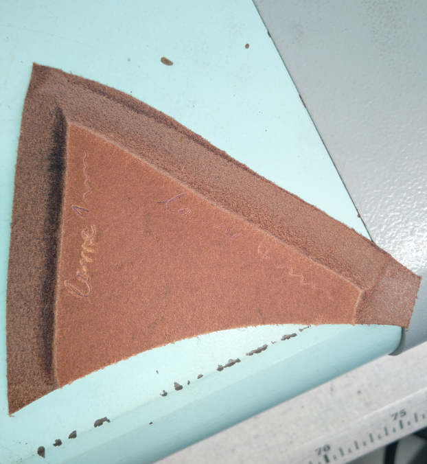

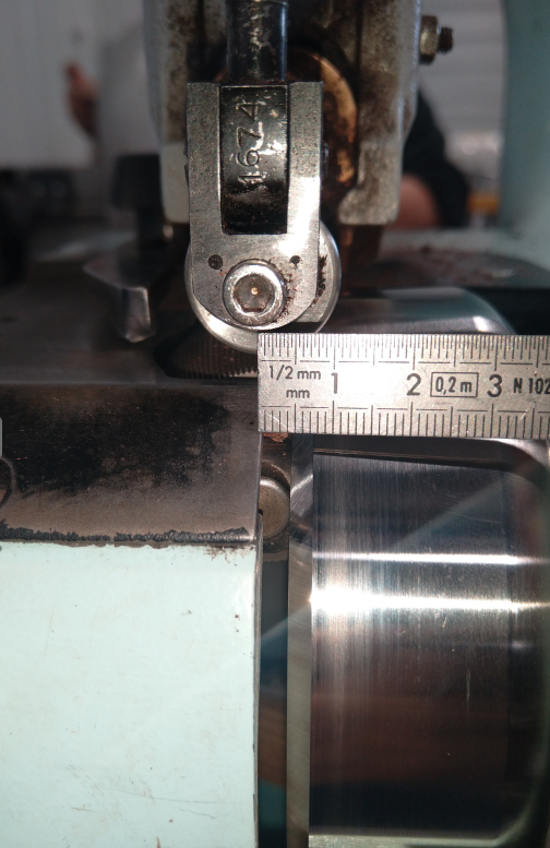

  1. Hello, I ever ask you somethings, and you were great for anwser, so i try with this new things! i work on fortuna KKS and 4mm thick hard leather i do that (pictures), some times after 15 parts of 10cm, the leather part don't go easly in... coudl you tell me which mecanic adjustement, i have to do? also, i would remove the mark left on the leather... Thank you for reading Julien
