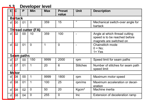

I own a Durkopp Adler H867 machine, it uses the Durkopp Adler OP1000 controller,
the problem is the following:
When I hold down the P button and restart, a menu opens through which I can change the operator (O) parameters and the Technical (T) parameters, but I can't use the developer (D) parameters at all.

I can't find any information about Developer mode (D), When I Hold P and Restart I get Operator (o), when I press A+ I get Technician mode (T), when I click A+ again I get back to Operator (o)
The D button is not a developer mode.
D+ increases parameter or selects sub program
D- decreases parameter or selects sub program
read pages 77 to 84

Again - there is no such thing as a developer mode on the OP 1000.
The program is pre-defined by the factory - you can only change parameters within the various functions/sub programs.
This is not an open source computer program - there are even different OP 1000 with pre set parameter possibilities/sub programs for different model Adler machines.
