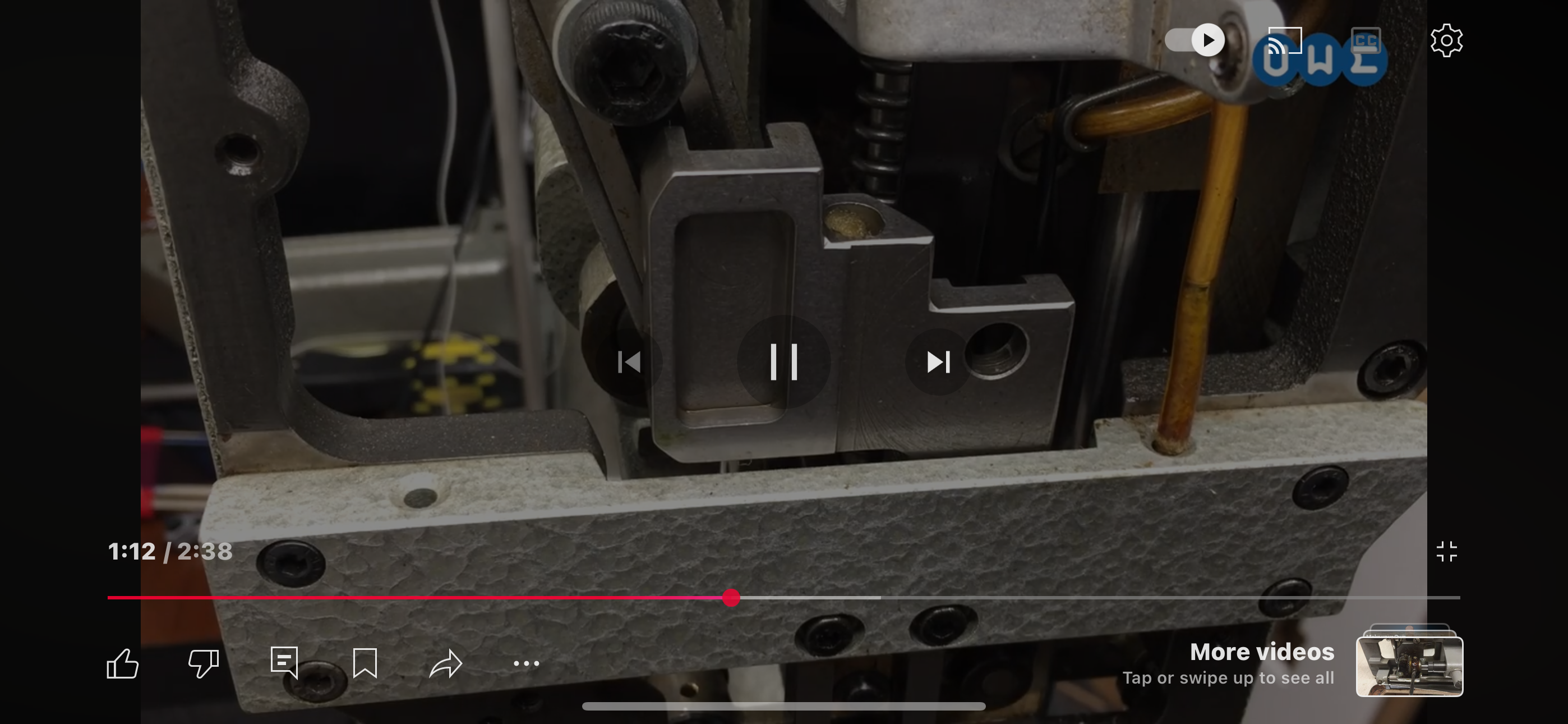

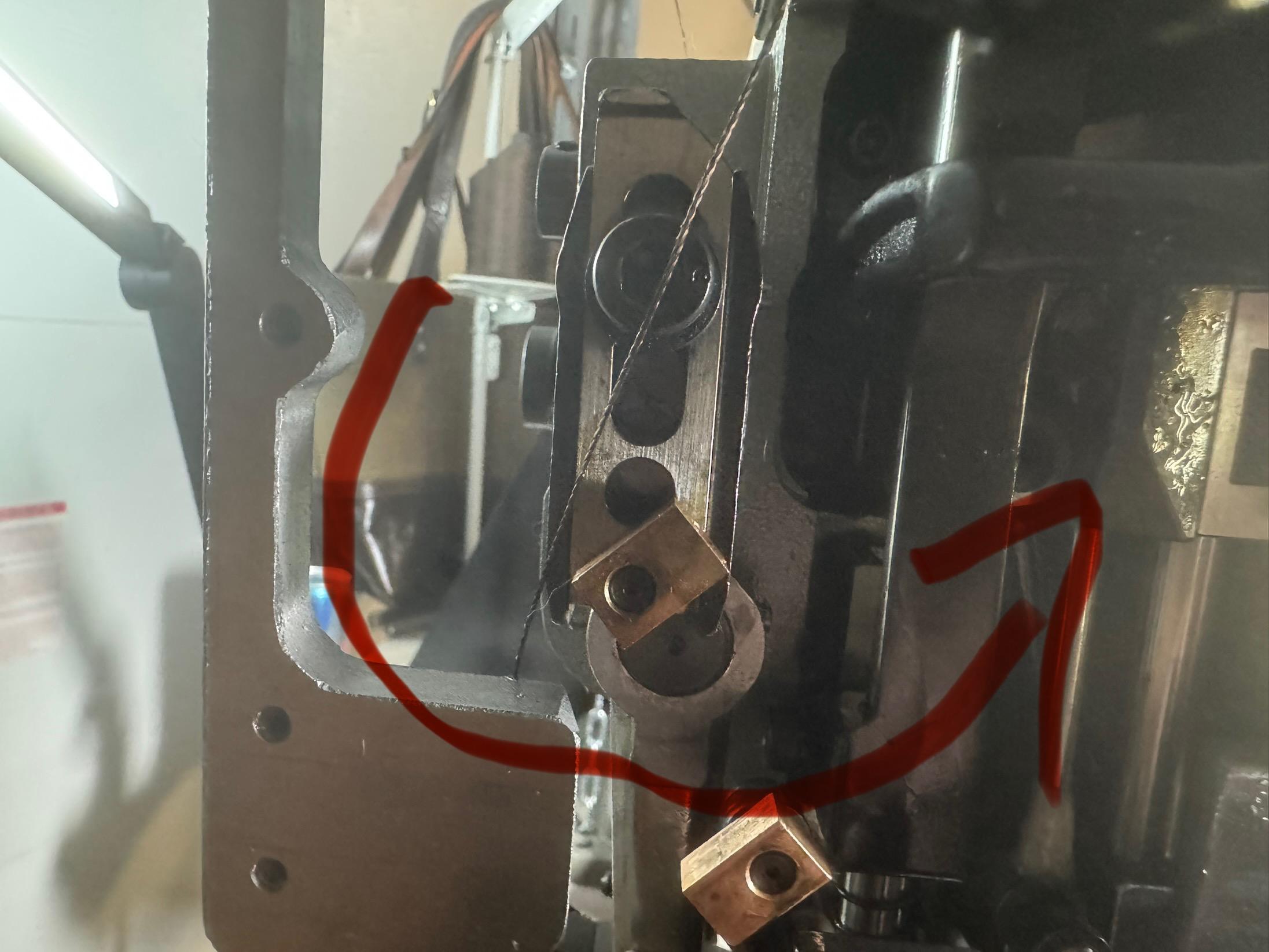

Members Kibitz503 Posted June 3, 2025 Author Members Report Posted June 3, 2025 (edited) 8 hours ago, nejcek74 said: Here is the adjusting manual: https://www.duerkopp-adler.com/fileadmin/dag/Media/Downloads/205/S_204_EN.pdf and a previous topic on the forum linking to Uwe's videos about the machine. I guess that was the video you were following for adjustment? If not, check it. Hey I appreciate you taking the time to reply. Uwe’s videos are great and I’ve watched the one you linked several times. I think this one is the adjust video you were referring to? (See attached I am unable to link it.) I’m certainly game for adjusting that again. it did give a pretty clear view of the bolt I’m concerned with. I added a picture with it highlighted in red. (See Attached) This is the bolt that came loose on me and I’m going to assume it needs to be set before the other adjustment. I can not for the life of me find info on where in the track it’s supposed to sit. I’ll try to use the picture to eyeball it. Edited June 3, 2025 by Kibitz503 Added second image Quote

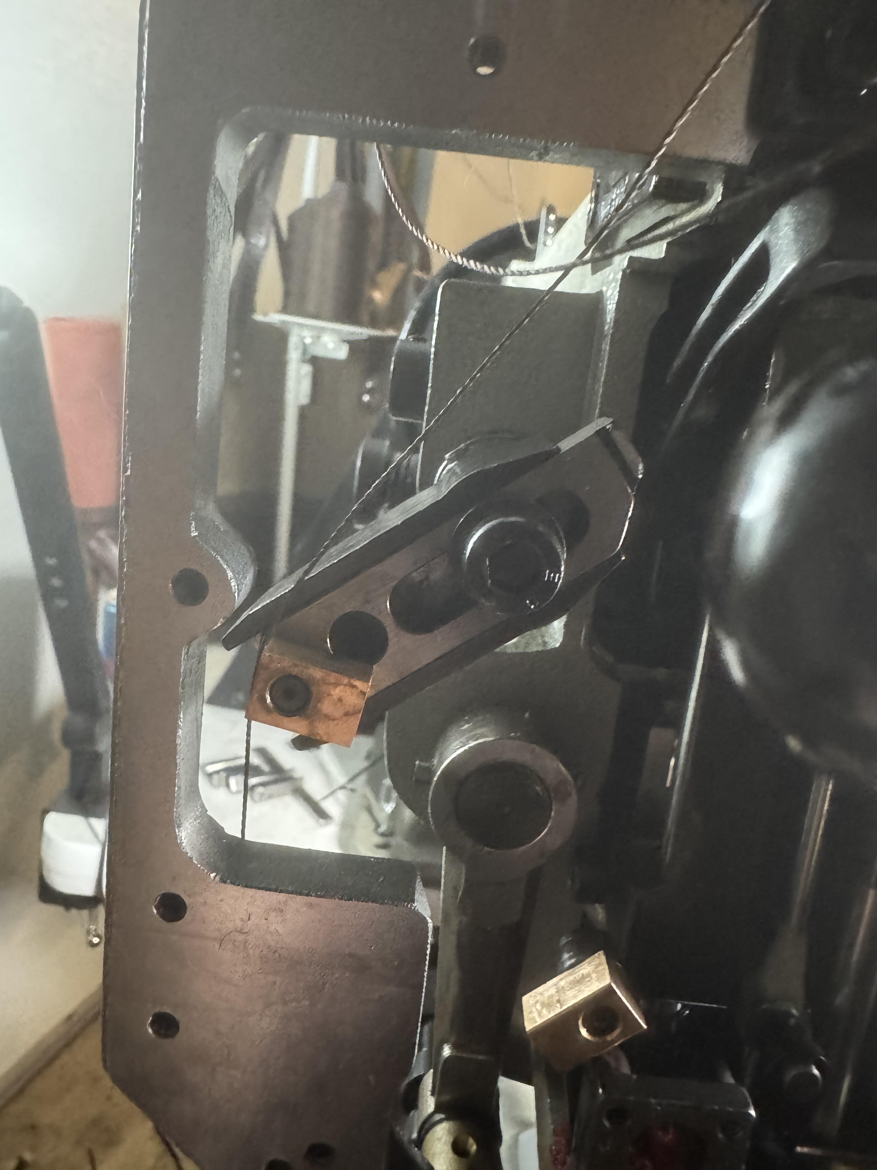

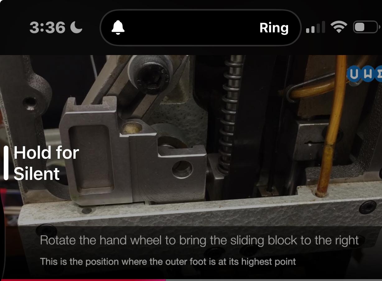

Members Kibitz503 Posted June 5, 2025 Author Members Report Posted June 5, 2025 (edited) I watched Uwe’s adjustment video several times. it looks like his arm that pushes the slider goes a lot farther towards the front of the machine and does not go as far backwards. Any suggestions about how to get it back in alignment? I attached photos of my machine at max extension vs his in the video. Edited June 5, 2025 by Kibitz503 Quote
