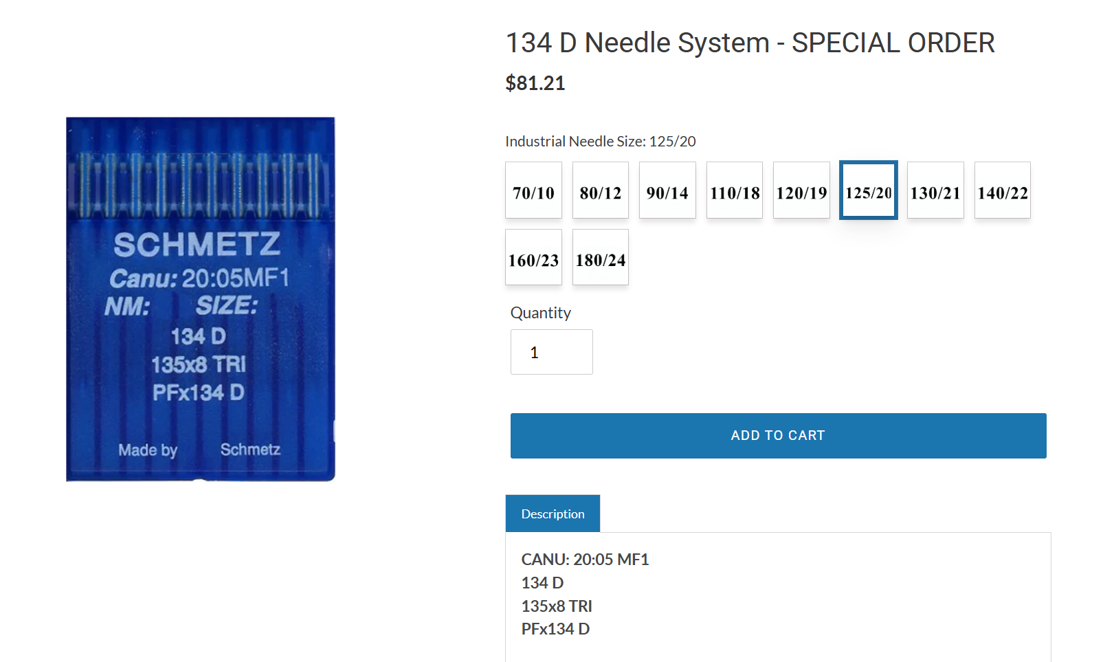

I need some helping locating information online on adjusting the hook timing on my double needle drop feed Singer 112w 115.  I'm moving to a larger needle (20) and need to know how to adjust the timing for these types of machines.   I have a needle bar that has no marks.  The instructions for this machine says it can still be done even without marks on the needle bar, but also says I should set the stitch length to 8. I'm not sure when I change the stitch length if it actually changes.
