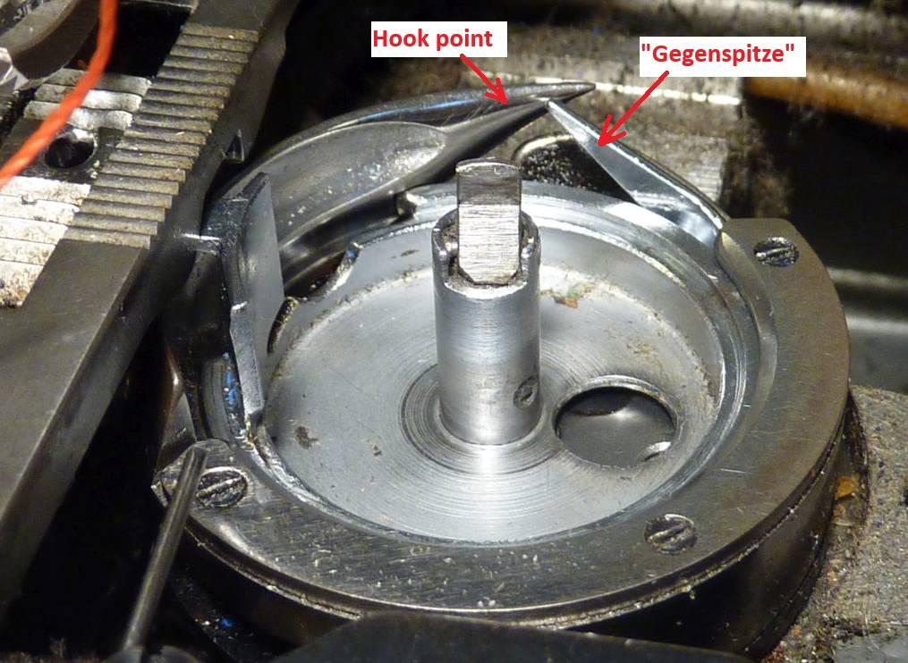

I know the German term, "Gegenspitze" for a point part of the hook, where the upper thread leaves the area, when pulled the last part up by the take-up lever. It is the point you see here:

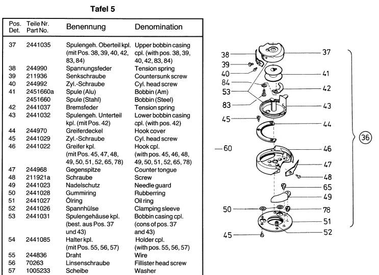

For some machines like the Singer 211W this "Gegenspitze" is part of the hook gib.
My problem is, that the thread is pulled hard by the take-up lever on this Gegenspitze before the thread finally is pulled off the end of the tip. I have read, that the reason for this tip is to avoid, that the hook may catch or damage the remaining thread when it comes around the second time. I know that only a few rotary hooks got this tip.

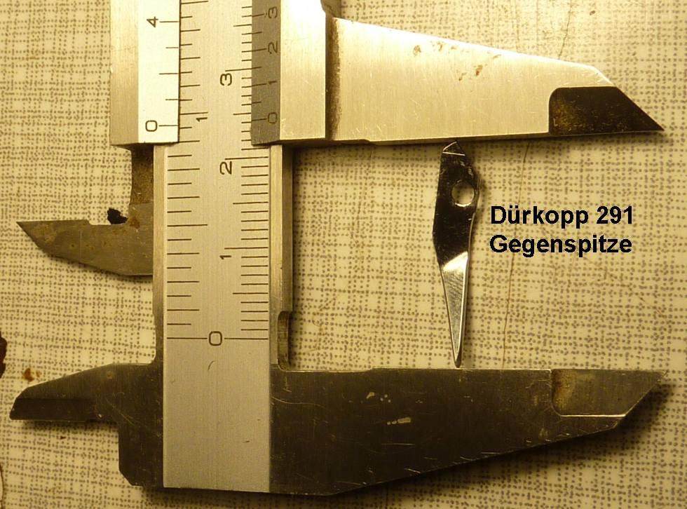

I have tried to measure the length of this tip when taken off in order to possibly compare the length with other users:
