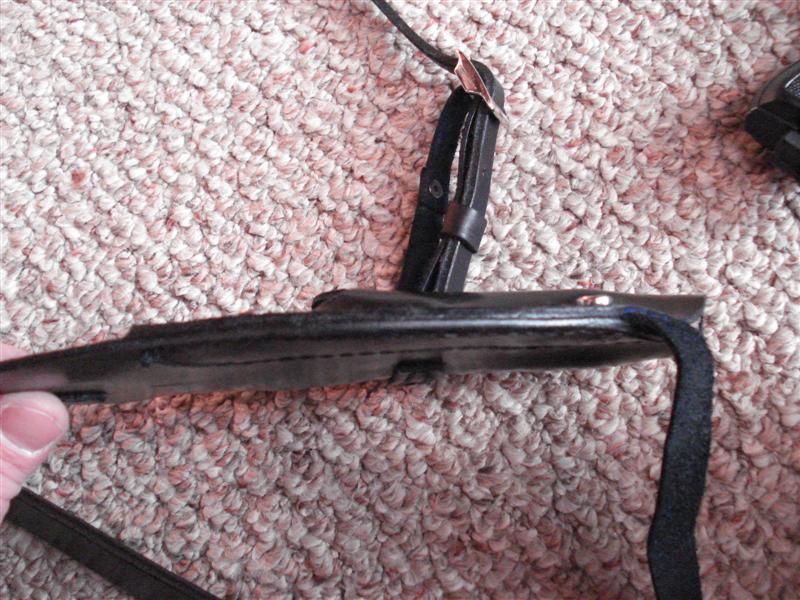

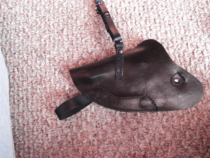

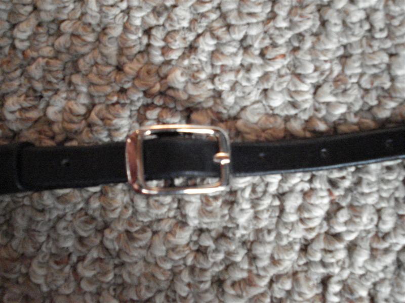

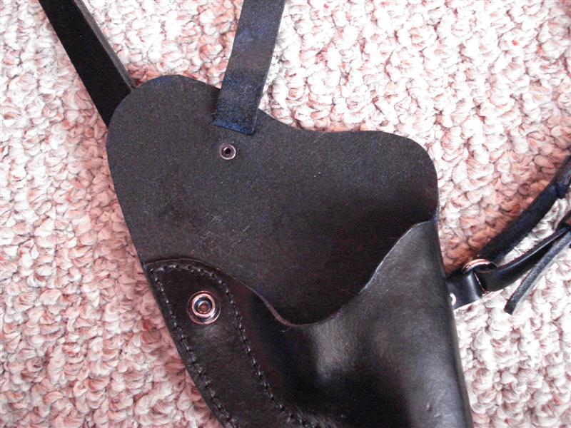

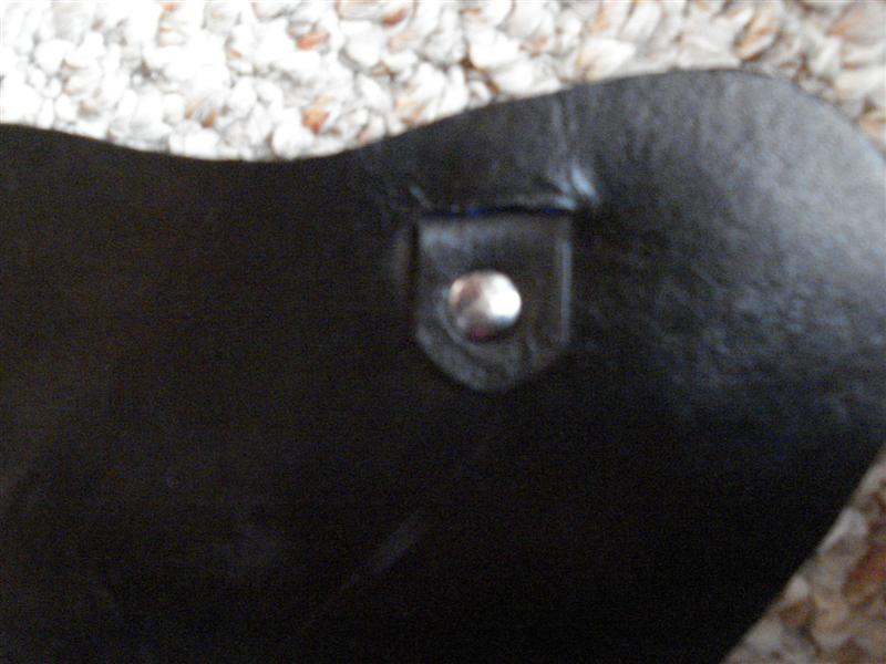

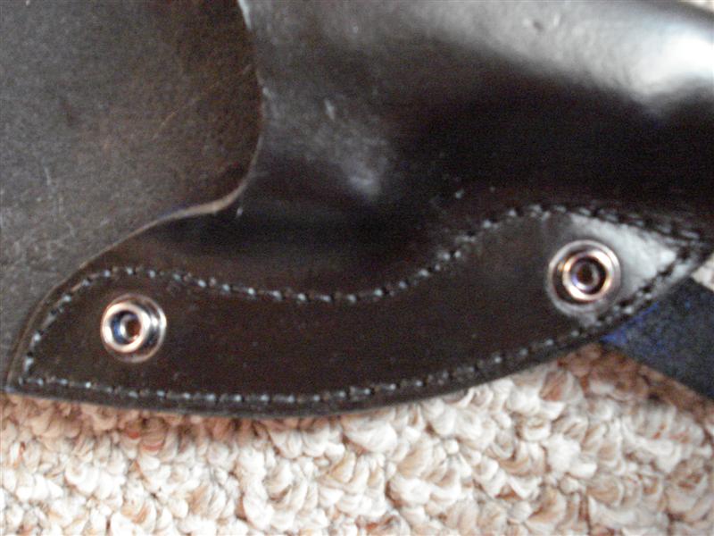

I put together a couple of kit holsters for my Neighbor and he asked if I would make him a shoulder holster for his Bersa 380. Well I could not turn away a challange and headed off for leather and such and I did get the Stohlman how to book. I read the book made a pattern and stole some ideas from my own shoulder holster which is a gov issue. I like the single strap design and the belt loop on the bottom. So with that said let me know what you think. If nothing else my stitching improved a tad bit. I used rivits wherever it would not show or touch the gun. I have not attached the top of the strap yet as I need him to come over and let me measure it for a good fit.

are those snaps standard on the shoulder holsters.
Not sure about other's but they were on the US Gov. 45 issued I kind of stole some of the design from it

Far better than I could do, but it looks like the trigger is too exposed. Cocked and locked, the trigger would be fully exposed, and to me, that is pushing the limits of safe carrying.
I would think that with a molded holster it would be less safe to push a trigger into a holster in the wrong direction. However I have seen holsters with far more trigger exposed than I have gone with and some with far less. In my humble opinion if you are carrying cocked and locked you’re not very safe to start with. The bersa 380 does have a firing pin safety that if properly engaged is covered by the holster and should be safe from getting disengaged. Just my opinion what do some of the rest of you think? I would like to know if trigger exposure should be or is an issue.

Interesting holster, Bighearn. Do you think it would be a little more comfortable with a wider shoulder strap? I guess it's not like the Bersa is too heavy though, huh?
The rig is very comfortable. The bersa is a light weight pistol and the 3/4" strap at shoulder seems to be more than enough. On that note the original holster that I took ideas from holds my S&W 45 Model 645 and the strap is a little less than a full inch and it is very comfortable even considering the weight of that pistol which is considerable in comparison to modern light weight 45's.
Now I carry all of my semi auto's unchambered saftey engaged. Just the way I roll I guess and I am not a police officer or do I need to carry for self defense "at least not yet". With all you said you still did'nt say "or at least I did'nt understand" weather you considered the trigger guard to exposed or not. I really would like to know if it is truly a safety problem I need to address in future builds.
In my opinion, if you can see the front of the trigger, it is too exposed. If you plan on making these for other people, you should probably add more trigger coverage. A lot of people won't use a holster that leaves any part of the trigger visible. I don't know if they're just being extra carefull or they don't understand that it's really hard to fire a gun by pulling the back of the trigger, but either way, you have to give folks what they want sometimes.
Thank you. I will take that into account with future holsters. I am inviting all and any criticisms I can get. I wont turn down any praises either for that matter. As to the owner of the gun he was extremely pleased (probally because I did it for free just to get one under my belt and because he is my neighbor and best friend). I just wanted to do one using my own idea (in a fashion) and making a pattern from scratch. I think I am heading down a path of no return. $ as well if I give em away.
