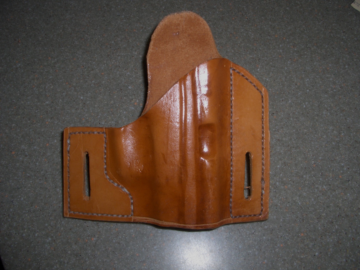

Here is another holster I created. I used white thread but I am not so sure I care for it. I also need to get some bag kote as the can of Fiebings Leather Sheen isn't working as nice as I thought it would. As you might be able to see the front got a bit shiny.

The thread color looks fine to me. Does seem a bit shiny more so with the flash I would guess. Looking good to me.
Your stitching look real good and I like the color. Myself, I like the looks of white thread on tan/brown holsters. I just checked out your first holster and like the rounded look of "the wings" a bit better. The squared off wing may tend get banged up after awhile. You may want to consider moving your front lelt slit up a bit. You will give your holster a nice forward cant and help to the pistol in closer to your body. My preferance is to lay out my my belt slits so the belt passes closer to the middle of the trigger guard. With a belt slide holster, some of the holsters retention qualities are directly related to the belt and belt slit placement.
