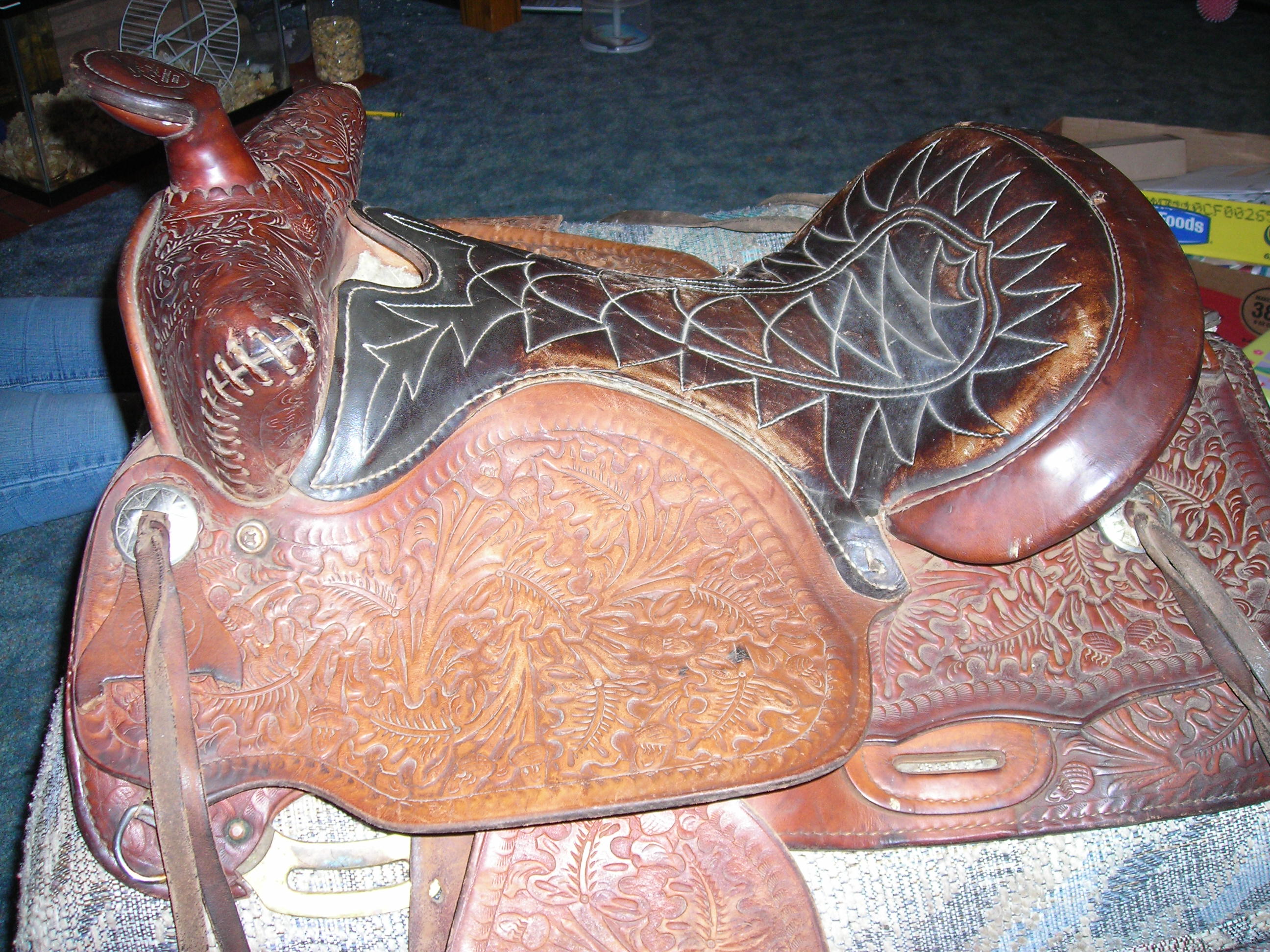

Here are some pics. I looked at Ralide's website and it looks like a model 1523 matches up pretty close.

The few cracked Ralide trees I've encountered were the result of someone putting the cantle screws a little too close to the stirrup slot. When I look at the pic Big Horn comes to mind as they often used that pattern along the edges.

This one looks more like someone drove over it with a truck. I glued it back together so I could get accurate measurements to order a new tree and it took a whole kit if JBWeld to cover all the breaks. I'll watch out for putting cantle screws too close when I put it back together.

IIRC back in the 70's Longhorn, I believe, had a few Larry Mahan models. However, the swell treatment looks distinctly vintage Big Horn, and the fact it's on a Ralide faux cutter type tree, the cantle, and the stamping, leads me to believe it would have been a lower end production saddle i.e. Big Horn or even a Simco. I'm thinking more Big Horn because Simco didn't typically lace their swells in that style - Simco's Little Wonder and cutter swells were typically a sewn split.
