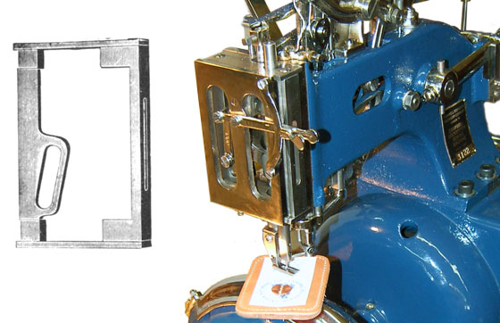

Members Kustom Posted June 20, 2009 Author Members Report Posted June 20, 2009 (edited) I hope they have some video of it in action. I've heard #9 had a very cool looking stitch and different from a regular sewing machine. I've never seen it but would like to. BTW, what does "square feed" mean? Edited June 20, 2009 by Kustom Quote
Members CampbellRandall Posted June 20, 2009 Members Report Posted June 20, 2009 I hope they have some video of it in action. I've heard #9 had a very cool looking stitch and different from a regular sewing machine. I've never seen it but would like to.BTW, what does "square feed" mean? Square feed refers to the feed frame system. It should have 4 corner contact to insure the feed is straight and true. The Campbell is designed with a square feed, which can pull straighter stitches on inclines and heavy materials. Needle feed is good, but in the needle and awl world, awl feed is better. The awl is stronger and less likely to flex or brake. Quote
Contributing Member TwinOaks Posted June 20, 2009 Contributing Member Report Posted June 20, 2009 (edited) From her description, square feed means that the needle goes straight down into the leather, then pulls it, as opposed to going down into the leather while it's moving. The advantage here is that there's no variation of stitch length when the material thickness changes- example: sewing a wallet where you go thin to thick to thin as you cross folds, seams, and pockets. Don't quote me on that, but that's how it was explained. The folks here with more experience might be able to explain it better. Edited June 20, 2009 by TwinOaks Quote Mike DeLoach Esse Quam Videri (Be rather than Seem) "Don't learn the tricks of the trade.....Learn the trade." "Teach what you know......Learn what you don't." LEATHER ARTISAN'S DIGITAL GUILD on Facebook.
