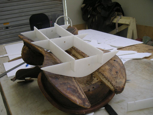

Maybe knowing this will make it easier for us to place A or R when we palpate for the shoulder blade, maybe we could walk the horse forward with A in place to see if it is disturbed? Should it be?
I think that it is a good idea to walk a horse around and observe and more importantly feel what changes in the horse’s back as it moves. I find it benefits my understanding. Once again I’ll refer to Pete Gorrell. Pete has people in his saddle fit class walk around beside the horse while it is being led, and they can feel with their hands on the horse and then also holding their hands down on a bare tree which is placed on the horse’s back as it walks. You feel the top-rear edge of the shoulder blade moving back under the front of the tree and also how much the tree is pushed around by the changing horse’s back.
It would be great if someone else who has been in Pete’s class could chime in here with their experience and thoughts. One thing that this exercise revealed to me when I first did it, is that as soon as the leg becomes unweighted the top rear of the scapula (the cartlage elongation of the scapula) blends in with the surrounding muscles, it is no longer as prominent, or causing a bulge as it moves back under the front of the tree or saddle. I’ve seen “saddle fitters” of english style saddles lift a horse’s leg forward to demonstrate how far back that top-rear of the scapula actualy moves, and then say that the saddle should not bear any weight in the region where the scapula moves. My issue with this is, there is then not enough room to left to actualy fit a western saddle tree. I’m sure that there have been lots of western saddles and pack saddles that have applied weight in the area where the scapula moves back to and they have not crippled the horse. What do other people think? However, having said that, I’ve been told that if the saddle is too narrow over the area where the top of the scapula moves back to, that it can make the horses “paddle” with their front legs as they move, because by swinging their legs wide, the top of the scapula moves in closer to the spine and thus relieves pressure against the inside of the channel area of a too narrow of a saddle. I’d be interested to hear what Blake has to say on this, he has a wealth of experience for us to draw on.

Now, knowing all of the above could I make the inverse of the cards to be able to check saddle fit to see if a previously built saddle will fit a horse I have measured?
Oh yeah this can be done. Over the years in development of the Dennis Lane Cards, we have investigated multitudes of potential adaptions, configurations etc etc etc.
Using the cards in this way will tell you one thing:--
IF THE TREE DOES NOT FIT THE CARDS IT DEFINITELY WILL NOT FIT THE HORSE!
However:-
It is possible that the saddle might appear to fit the cards, but not fit the horse.
Reasons why we are not promoting the use of the cards in this way:
1/ Just because the inverse of the cards used in this way do not show up any problems with the saddle fit, does not mean that there will not be any problems with this tree on a horse whose back has these card-size measurements.
2/ The cards measure 4 profiles of the horse’s back. We believe this is sufficient information, achieved at an economical cost for the practical purposes of what I call effective "Macro-fitting” of saddles to horse’s backs. For “micro-fitting”, more detailed shape measureing can be achieved with other measuring devices or casting methods, but at considerably higher cost. Cost not only in price of equipment but also expertise in using the equipment.
3/ If we promote using the cards this way and someone checks a saddle for fitting their horse in this manner, prior to purchase and then that saddle hurts their horse, Dennis and Dave will be very unpopular! Despite the fact that there are many other factors which could be causing the problem, such things as rigging or padding, factors which also are being discussed at length in topics of their own on this forum.
4/ There is a fair degree of interpretation required to successfully use the cards in this way, which experience treemakers and saddlers can handle, however the average person with limmitted knowledge and experience will be far more prone to error.
5/ It is a big enough chalenge for me to write the instructions for the cards as they are now, adding instructions for your suggested features and explained at a level at which the general public could understand and implement them effectively is beyond me!
We are not saying “do not use the cards in this way” just saying that we are not promoting their use in this way.

I to have used the cards in a similar fashion only for my own curiosity...with one difference though. Instead of using the rock cards for gathering data, I use them to test my theory. First I find all three appropriate card profiles, then make a top line template and mark the intersection points. Inverse profile cards are made and fitted together as David has done, building a model. The top profile template positions A,B,&C in the proper position to check to see if I had chosen the proper rock card in the first place. Theoretically this places B in relationship to A & C properly. I've only done this once and everything checked out as my theory intended, but this is not to say this is fool proof in any way. The placement of the cards and establishing the proper planes is somewhat subjective. I know that Dennis and David have given very clear instructions on how to use the system, but I have had a couple of customers give me totally incorrect rock profiles that resulted in a totally incorrect tree. The top line was much easier to determine than the placement of the rock card for them. I wish I had taken pics and archived the info of this process but I did not. I have though, included a drawing of the intended results. Hope this makes sense. Do I even macro-fit on a regular basis? The answer is no. I do these things to try and gain a better understanding of Dennis's system and it's inner-workings and potentials to adapt to my system of construction. I like systems!
