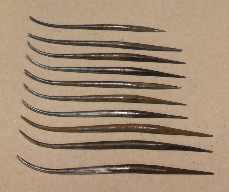

Members amuckart Posted February 26, 2010 Members Report Posted February 26, 2010 I'm working backwards through this thread right now so I don't reply to things that are already covered. As usual, Terry has hit the nail on the head. Unless you have the right tools you really can't hope to get up to speed with this task. IMHO, the triangular section hole could actually inhibit speed because the sides of the hole will close up when the needle is withdrawn. Personally I'd shell out the not-very-many $s for a nicely finished curved awl, Doug - lets face it, unless you really get into this type of work it will probably be the only one you buy! Okay, I'll admit to having three - each a different size, but I'm a sad man who should try to get out more... I've got a small collection of 12 or so curved awls for various things, mostly old Barnsley and King awls but by far the nicest was made by Dick Anderson at Thornapple River Boots. That said, when I'm making medieval shoes I use what they did, which is a straight awl. Curved awls are a post-medieval thing. Back in The Day™ they used straight awls even for tunnel stitching. It's quite doable but it's a very different technique than using a curved awl (which I'm not very good at). All the shoes on my blog were sewn with straight awls I made myself out of random bits of tool steel. Mostly old allen keys I chopped the bent bit off of, threw in a drill mounted in a vice and went after with a dremel while it was spinning. Man, I hope there aren't any machinists on here, that'll probably give them conniptions The awls I use are round, tapered with a slight chisel point and a mirror polish. They're not quite the same as the shape of medieval awls but my forging skills aren't up to reproducing those yet. I meant to throw in a few words about stitch marking wheels. I like to use the 'pricker wheels' that were popular in the 1920s/30s. They can be purchased quite cheaply on eBay and IMHO are a much nicer thing to use than the standard TLF offering. The little spikes make less mess than the big chunky markers and the neat little holes are easier to see. Regarding thread, I'm in complete agreement with Terry (again). Get thread that suits the awl and the job you are doing with it. I use linen thread for most of my historic work because it is what would have been used at the time. IMHO it also seems less likely to cut the leather than synthetic - particularly important for shoes which are sometimes wet - wet leather is often soft leather. Linen seems to have more 'give' and 'tolerance' to use. I haven't used anything but linen for a while. With a good hand wax it locks up way tighter than I can get with synthetic and if you ply up your own cords you can tune the thickness to exactly what you need for the seam you're building. Personally I don't use a pricking wheel, I just eyeball things. I've only got one and it's 13SPI which is a lot finer than I need for most things. Extant medieval shoes show the natural slight variations in stitch length that comes with an awl-as-you-go technique done by eye. Still, I mostly manage fairly tidy seams on things. Now I have a question : how do you guys finish the soles of your shoes? I ask because single thickness sole turnshoes are notorious for soaking up moisture (okay, I know they should really be worn with patterns). I saw a pair a week or so ago that had a 'riveted on' sole that seemed to work quite well but I'd be interested to know your thoughts. From a historical perspective, is there anything to suggest that they may have had extra soles added? Not in medieval work, no. Distinct outsoles don't start being used on new shoes as a matter of course until the very late 15th century/early 16th century. There are oddities of shoes with built up soles, but they're oddities. The vast majority of medieval footwear was single soled. Sometimes you see ones that have had repair soles put on but that's often a pretty temporary and crudely-done repair. I tallow my shoes, but there really isn't a lot you can do to make a medieval shoe waterproof. If you walk in the wet and mud you're going to get damp feet after a while. Pattens are the real answer, and they aren't nearly common enough in reenactment IMO. It may be that they had specially heavily curried leather in medieval times for use as shoe soles but I'm not aware of any research to back that idea up. Quote -- Al. Medieval Stuff: http://wherearetheelves.net Non-Medieval, including my machines: http://alasdair.muckart.net
Members truetruth Posted May 24, 2011 Members Report Posted May 24, 2011 Hey all - medieval shoes had wooden soles that could be attached underneath them to keep them dry...found some at the York dig...FYI. Cheers, Don I'm working backwards through this thread right now so I don't reply to things that are already covered. I've got a small collection of 12 or so curved awls for various things, mostly old Barnsley and King awls but by far the nicest was made by Dick Anderson at Thornapple River Boots. That said, when I'm making medieval shoes I use what they did, which is a straight awl. Curved awls are a post-medieval thing. Back in The Day™ they used straight awls even for tunnel stitching. It's quite doable but it's a very different technique than using a curved awl (which I'm not very good at). All the shoes on my blog were sewn with straight awls I made myself out of random bits of tool steel. Mostly old allen keys I chopped the bent bit off of, threw in a drill mounted in a vice and went after with a dremel while it was spinning. Man, I hope there aren't any machinists on here, that'll probably give them conniptions The awls I use are round, tapered with a slight chisel point and a mirror polish. They're not quite the same as the shape of medieval awls but my forging skills aren't up to reproducing those yet. I haven't used anything but linen for a while. With a good hand wax it locks up way tighter than I can get with synthetic and if you ply up your own cords you can tune the thickness to exactly what you need for the seam you're building. Personally I don't use a pricking wheel, I just eyeball things. I've only got one and it's 13SPI which is a lot finer than I need for most things. Extant medieval shoes show the natural slight variations in stitch length that comes with an awl-as-you-go technique done by eye. Still, I mostly manage fairly tidy seams on things. Not in medieval work, no. Distinct outsoles don't start being used on new shoes as a matter of course until the very late 15th century/early 16th century. There are oddities of shoes with built up soles, but they're oddities. The vast majority of medieval footwear was single soled. Sometimes you see ones that have had repair soles put on but that's often a pretty temporary and crudely-done repair. I tallow my shoes, but there really isn't a lot you can do to make a medieval shoe waterproof. If you walk in the wet and mud you're going to get damp feet after a while. Pattens are the real answer, and they aren't nearly common enough in reenactment IMO. It may be that they had specially heavily curried leather in medieval times for use as shoe soles but I'm not aware of any research to back that idea up. Quote
