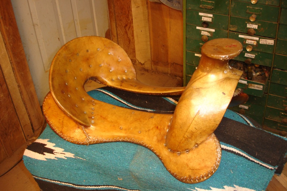

Members rwc Posted March 25, 2008 Members Report Posted March 25, 2008 Here is a Wade tree that I ordered from Hadlock and Fox Quote
Members AndyKnight Posted March 25, 2008 Members Report Posted March 25, 2008 Rwc, That Tree i would consider a wade by name only... JMHO "A lot of tree factorys still haven't figured this out. " Quote Andy knight Visit My Website
Members rwc Posted March 25, 2008 Members Report Posted March 25, 2008 I, personally, would love to see a picture of a true wade tree. Can you post one? Quote

Members jonwatsabaugh Posted March 25, 2008 Members Report Posted March 25, 2008 (edited) rwc, Get on Kent Frecker's web site, click on saddle trees and you will see some great examples of Kent's and Lennis Arave's Wade trees. Also Rod Nikkel has very fine examples on his site also. Jon Edited March 25, 2008 by jonwatsabaugh Quote
