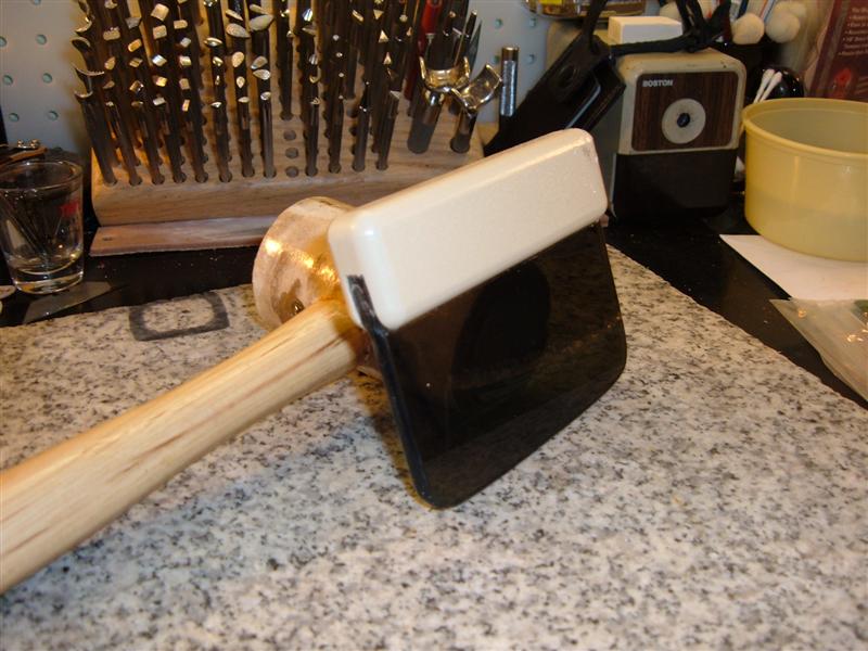

I have seen pics of a few, they don't look too complicated with a table saw or router to cut a channel and a scroll or band saw to cut the shape, some glass and epoxy then a lot of sanding and polishing to round over the edges. Uh Oh, I feel a project comin on! A slicker smooths seals compresses and fixes dents on flat areas rather than the edges of the leather. and around curves as in saddles.

I made mine, just went to the glass shop and asked for a piece of 1/4" glass about 4.5 inches by 6", or what ever you want. I asked then to sand and polish the edges and two corners off. (rounded off smooth) Then glued some leather on each side for a handle, it works great.
I went to walmart and got one of the small cutting boards made from a plastic, I think. Then cut it in half and rounded the edges of both with my sander. Works great and I have two for the price of one.lol Boy, if walmart knew that they would charge me double. hahaha I guess this is ok.. Seems to work fine. Would glass work better than this?
On another forum, The late Verlane Desgrange Had a tutorial on making a slicker. I made mine out of 1/4" plexi-glas, The handle is made of a marine grade polymer we use at work.
