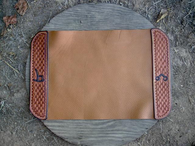

I make my placemats a little differently, and will attach an example. These are a chap leather body with tooled side borders. I mostly use chap leather for the bodies, but have used some oiled vegtain too. I use Feibing's Leather Sheen. I have used Future floor wax in a pinch and don't see any difference. I put on on a pretty good coat, when it is almost dry, I put on a light coat. When it is just past tacky, I put another light coat on. I usually end up and have about 4-5 light coats when I am satisfied. I have not had a problem with staining, our own set is used a lot, and out maybe 8 years now. They wipe with a damp rag. I have customers who roll them up in drawers for storage, ours are sometimes. No problems with flaking or cracking.
