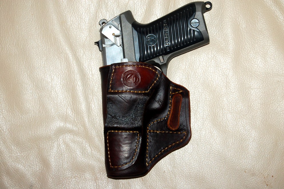

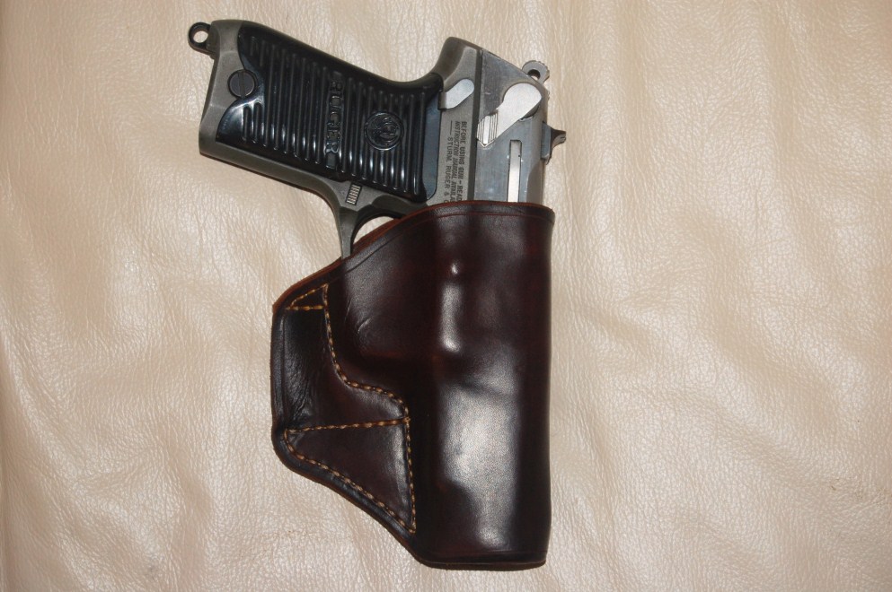

Thank goodness this was just a trial holster. I have been wanting to try out Lobo's avenger style holster. Got a side of Wicket and Craig saddle skirting skived down to 7-8oz. Drawed out my pattern to my Ruger P90 and finally ended up with a pattern I liked. Cut everything out, grooved a stitch line, and dyed everything saddle tan. Got everything sewed together....with a couple mistakes, but as I said this was a trial run. Dunked in water for 2-3 seconds, then worked the gun into the holster. It was a tight fit. Got out my brand new in the box heat gun and started drying the holster. Holy mackrel........the leather wilted like your fingers do when you've had them in water a long time. Lesson learned, keep heat gun in box! But............I like the fit and style of the holster. There are several mistakes, besides the wilted part, that I will correct. The gun fit tight, but loose enough for fast draw. The holster was snug against my side and the gun did not bow out. The fast heat dry hardened the holster to a nice degree. Got the back side belt loop to close to the stitch line, so there are several corrections to be made.
The leather I got from Wicket and Craig was excellent. Nice and smooth flesh side. They have me sold on these.
Thanks Ray for helping me with this. Hopefully the next one will be better.

Bill: I received your e-mail and responde so you should have that by now, with a few suggestions on design elements.
General comments:
The use of heat can be very useful in achieving the most rigid results in holster forming, but it is easy to overdo the heating. Too high a temperature, or too long an exposure, will damage veg-tanned leather.
Heating will activate collagens in the leather fibers, which causes the difference in the final structure. Once the necessary degree of heat has been reached the result will occur, so there is no need to complete the drying process at temperatures above normal room temperature.
Heat guns can be used but, as you have found, the flow of super-heated air must be kept moving and not allowed to concentrate on a single area. A better approach for the hobbyist or occasional maker would be the kitchen oven. Most ovens have a minimum temperature of around 170 degrees, which is hotter than the 130 to 150 degrees necessary for the purpose. So, short exposures (about 10 minutes at a time) should be used. For those who do detail boning on their products this provides a good opportunity to complete that process easily at intervals of decreasing moisture content.
Convection ovens will generally operate at a lower temperature (around 150) and feature a fan to keep the air moving, so these are better for the purpose than the kitchen oven.
For those making holsters on a regular basis a drying cabinet can be useful. A heat gun or even a hair dryer can be used to produce the heat and to induce air flow into the cabinet, and a thermometer will allow temperatures to be monitored and maintained within a fairly narrow range. Once the desired level of heat has been applied the heat source can be stopped and the contents will continue drying as the temperature gradually dissipates. Additional applications of heat can be done as desired.
