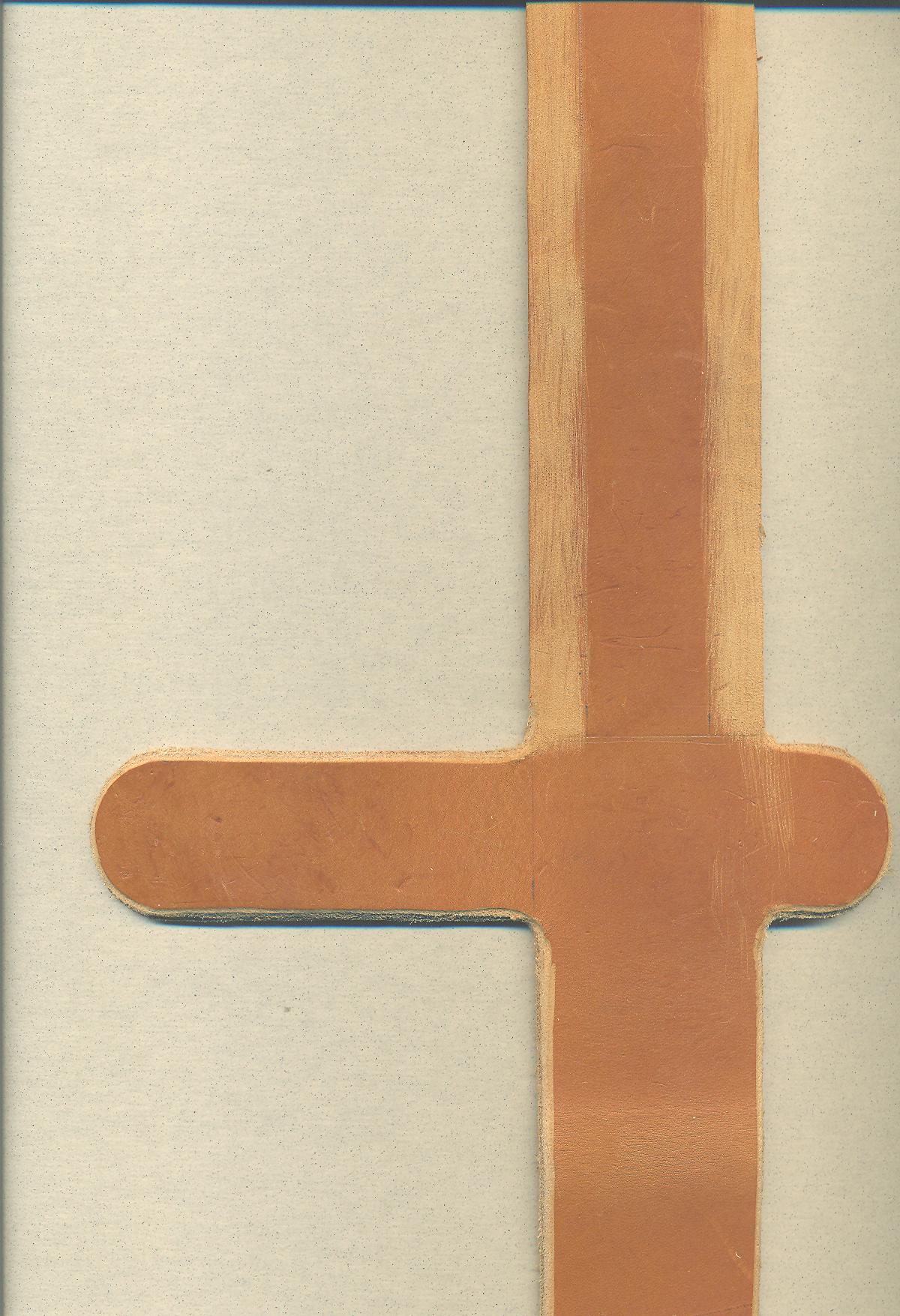

Hi Everybody !
I'm working on my first serious leather project.........a sheath of my own design for a digging tool. The design is simple, a Front and Back, as shown in the attached pics. The Front is wider than the Back of course, to enable forming a pocket for the tool. The Back includes a retainer strap for the tool handle and a mating tab for a Zack White line 24 Buffalo Nickel snap set.
The leather I'm using is 12 oz.. Veg-tanned. I know this is thicker than necessary for this project and is harder to work with, but it's all I have and can't justify buying more leather. I roughly rounded the edges, using a Midas Edge Beveling Tool # 8076-3 and plan to further round and smooth with fine sand paper by hand. I'll be following the Bob Park's "Finishing Edges" steps as far as sequence of operations goes, and substituting some of the finishing products with the following:

I foresee a problem controlling the black dye when applying it to the edges of my project and am seeking ideas. At age 69 and taking medications over the past 17 years for (4) health issues, my hands aren't as steady as I they used to be.
After the dye is ready, I plan to practice with some scraps of the 12 oz. leather.
Here are some of my own ideas to keep the dye in a straight line, but would appreciate opinions from those of you with experience. :notworthy:
