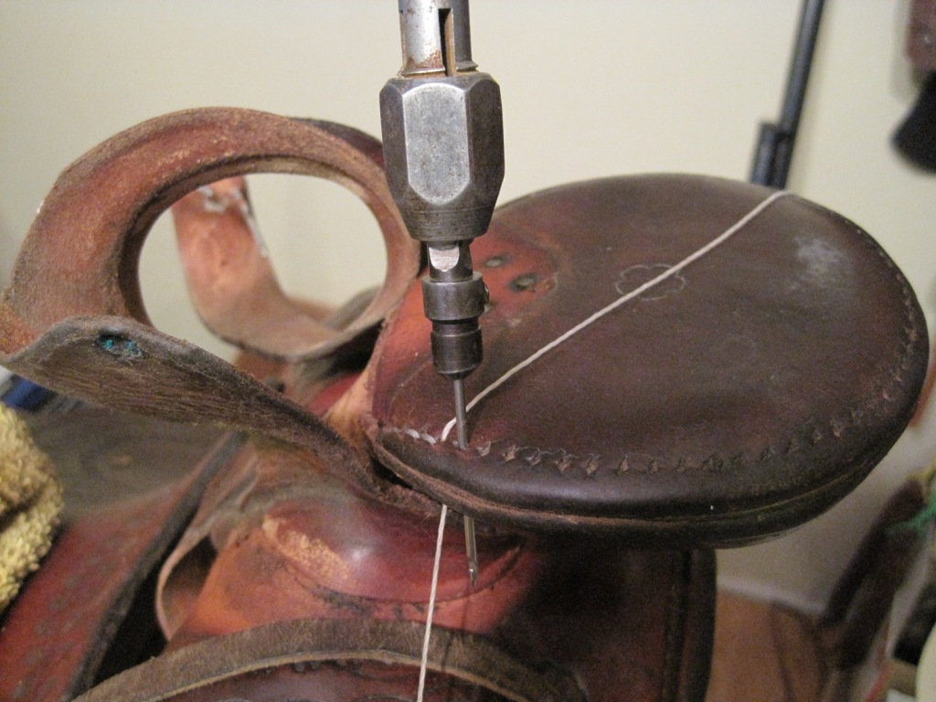

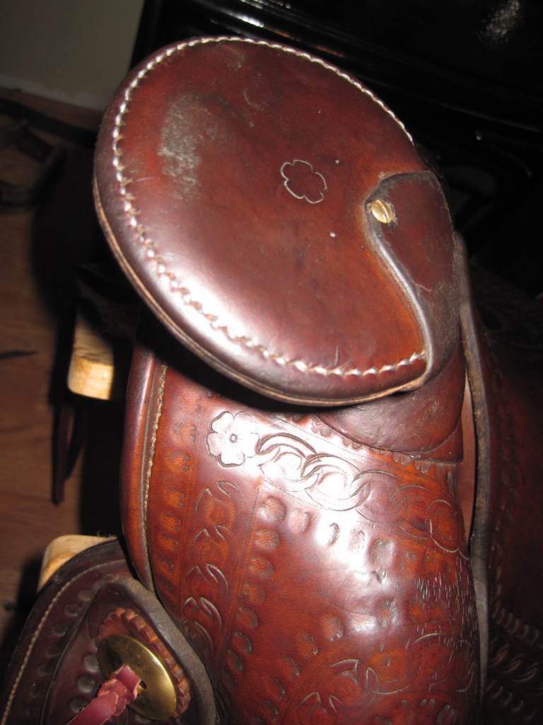

Alright Dave, I remembered to take a few pics, one 'in-progress' of re-stitching the horn and a few final photos.

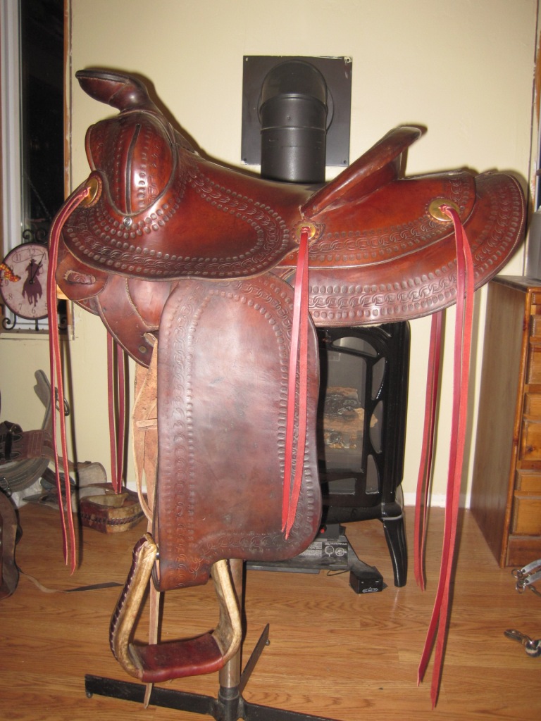

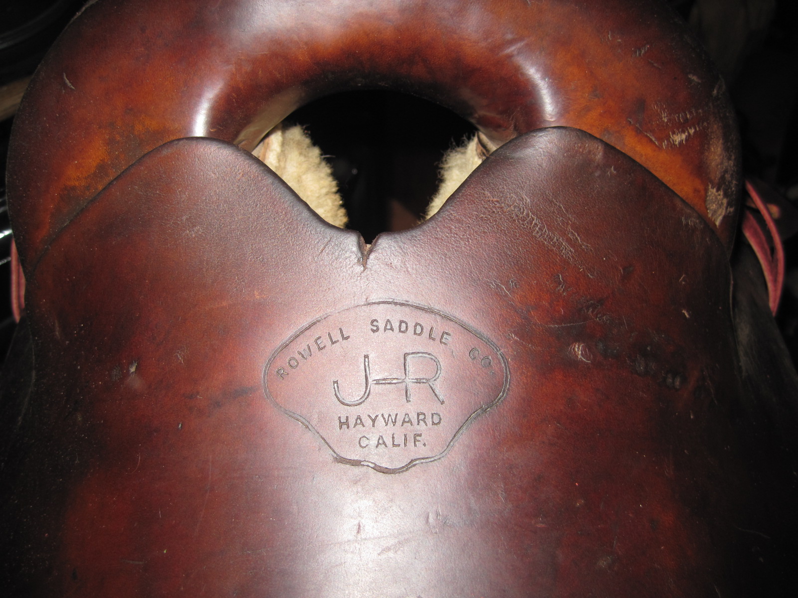

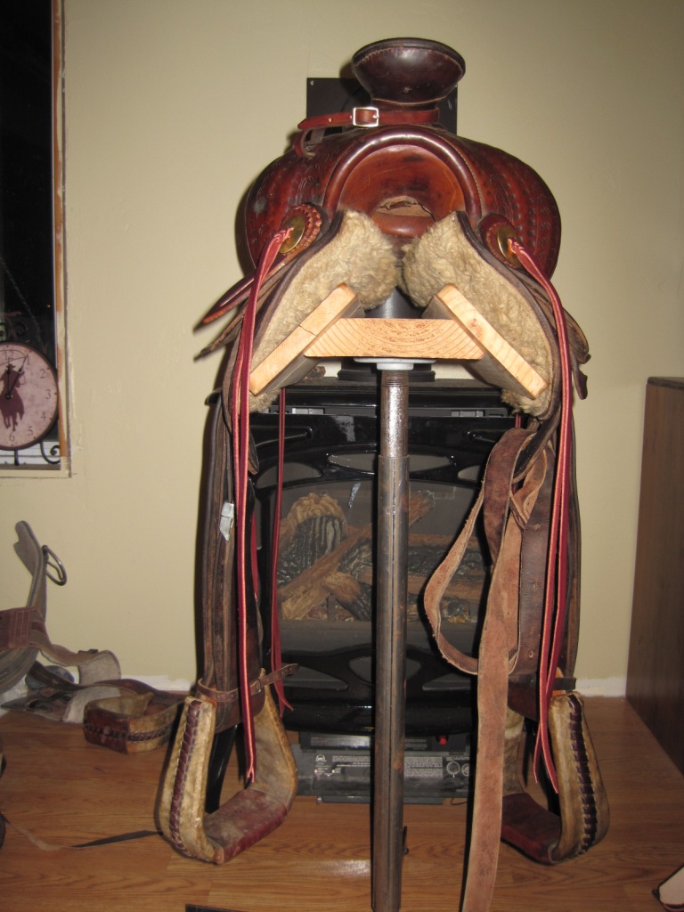

Here is the Rowell saddle pretty much done, just have two more strings to do.

Can give you some history on the Rowell but came up blank on the Thomas. Harry Rowell was born in Peterborough, England. He joined th British Navy
and after discharge went to Canada and then to Calif in 1912. He was a rancher and promoted rodes and in 1940 went into saddlemaking with
Victor Alexander. In 1942 Alexander left the firm and the named chaged to Rowell Saddle Co. and he remained in the business untill 1961 with
several shops in various Calif locations. Hope this info will be of some help to you.

Thanks for the info on that saddle! I wasn't real sure as to the age of the Rowell as it doesn't have any 'dating' characteristics that I recognise. It's a style that my dad, an outfitter, would use in the mountains and you can find similar saddles new. It does have that half horn cover deal with the screw on the top of the horn, which isn't common anymore (I think...).

As would be expected for the time (has an early 50's look) , it's pretty narrow and steep angled in front. It is in great shape though and a good cleaning with a glycerine based cleaner would have been time well spent. It's a little too new to be a "restoration" so for someone looking for a well made kid's saddle for use on smaller horses with angular conformation it should bring somewhere +/- $300. I'm not at all familiar with your market but I would be a little picky about who I sold it to. A heavy user on big horses could end up with a bad experience and tell all their friends about it. As for the other one it may be a little older but not much. Good brass hardware like the EZ rig front dees was just about impossible to find until after WWII and high priced until after the Korean conflict, too high priced for use in a low end shop made saddle like that one. If its narrow like the other one you would probably be in the same pricing boat as with the other one maybe worse because of the bigger seat.
I'm thinking the stirrups on both saddles are not originals. Considering the excellent quality of both saddles they'd have had leather bound stirrups. The laced rawhide are a style that came later. The metal bound were seen on economy saddles, usually mail order saddles, of that era.
