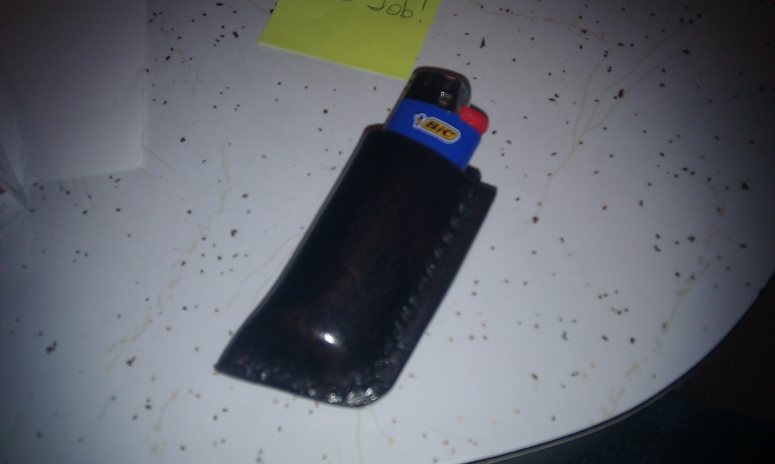

Members jbird22cal Posted January 12, 2011 Author Members Report Posted January 12, 2011 While I was waiting for my leather to case properly I started down this road. Following the instructions for the pocket knife case in Al's book, I made this case for a bic lighter. I managed to rush it a bit and still have it turn out ok. (took about 4 hours w/o final finish) Things I learned: 1. check to make sure that brand new bottle of eco-flow glue you got is not dried out before you start. 2. the handly little awl that has inter-changeable blades that tandy sells is a bit bothersome, the blade sticks and pulls out. 3. Don't race when your using elmers tacky craft glue (all I had on short notice) 3. Sewing needles break despite everything being coated in beez wax. 4. a dremel tool will be handy in sanding the edges, as far as finishing it I used am artgum eraser with a piece of cut 600 grit sand paper. ( I learned to use a gum eraser for sanding from a machinest friend of mine when he was doing some work on a rifle stock) 5. Gum T accepts die, had no clue what exactly to do with this stuff. All I know now is that I will run out of that stuff first. 6. that new plastic bone tool from tandy needs to be sanded on the edges, also watch the made in china stamp. 7. Gravity applies... when your stitching pony is between your legs stuff always seems to fall out of reach. 8. when double stitching the belt loop as per instructions, leave it on the looser side as to not spread the hole out in the case. 9. If you need to take a break, take it! that way you dont forget to cut a stiching groove. I'm sure there are a few things im not typing in but thats good enouph. I'm sorry about the quality of the picture, the lighting wasnt great. I've got lots of compliments on it. My own critiquing is that I could have made it so the lighter rides lower. It bites me in the love handle. The edges were easier than I thought. Quote
