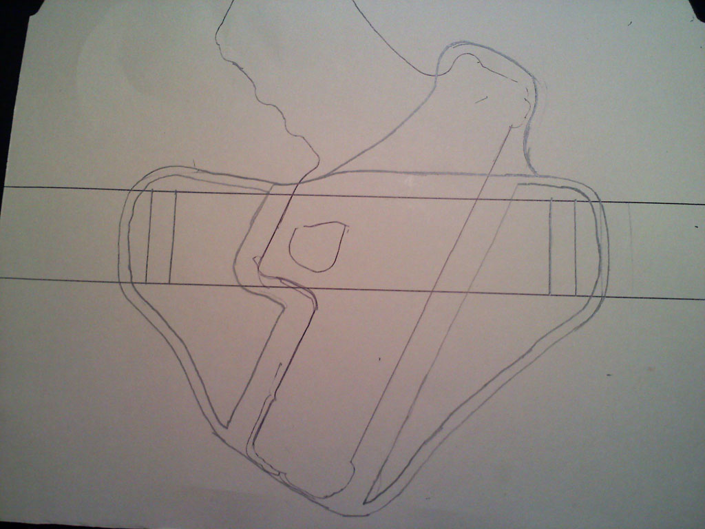

Members Big O Posted March 8, 2011 Members Report Posted March 8, 2011 Pancake holsters are probably the EASIEST type to make your own pattern for. All you need is: File folder or other stiff material pen/pencil ruler compass (optional but helpful) scissors pin/needle/other sharp pointy implement My procedure: draw belt on material place pistol on top of belt lines at the height/angle you want to carry it trace outline of pistol measure width of pistol draw your stitch lines at a distance 1/2 the width you just measured away from the pistol pick locations for belt slots along the belt line and outside the stitch lines, and mark them in draw the outline of your desired holster shape, outside the belt slots cut out the shape That's your pattern right there. Now, put it on top of the leather and trace the outline. Flip over the pattern, put it on a different area of the leather and trace the outline. Cut those pieces out. Put the pattern on top of each piece and use your pointy thing to stab through the pattern into the leather in spots to mark the locations of the stitch lines and belt slots. Done with the pattern. Quote https://www.facebook.com/BigOGunleather

Members Big O Posted March 9, 2011 Members Report Posted March 9, 2011 Here's a photo of a pattern I just drew today, for a Glock 17/22/31 pancake to be worn behind the hip: Quote https://www.facebook.com/BigOGunleather
Members yehagirl Posted March 9, 2011 Author Members Report Posted March 9, 2011 Thanks for the detailed instructions. I think I can follow that! I was thinking that the pattern had to be a set shape... But what you are telling me is that it can pretty much be any shape that suits my fancy? Like a big pair of lips, a heart or some other girly shape? Thanks again - both of you. I will post my girly holster when I get it made! Here's a photo of a pattern I just drew today, for a Glock 17/22/31 pancake to be worn behind the hip: Wow. THanks for that... Quote

Members slam Posted May 24, 2011 Members Report Posted May 24, 2011 Thanks for the help Here's a photo of a pattern I just drew today, for a Glock 17/22/31 pancake to be worn behind the hip: Thank you for sharing your design! now I need to get to work... cool site. Quote
