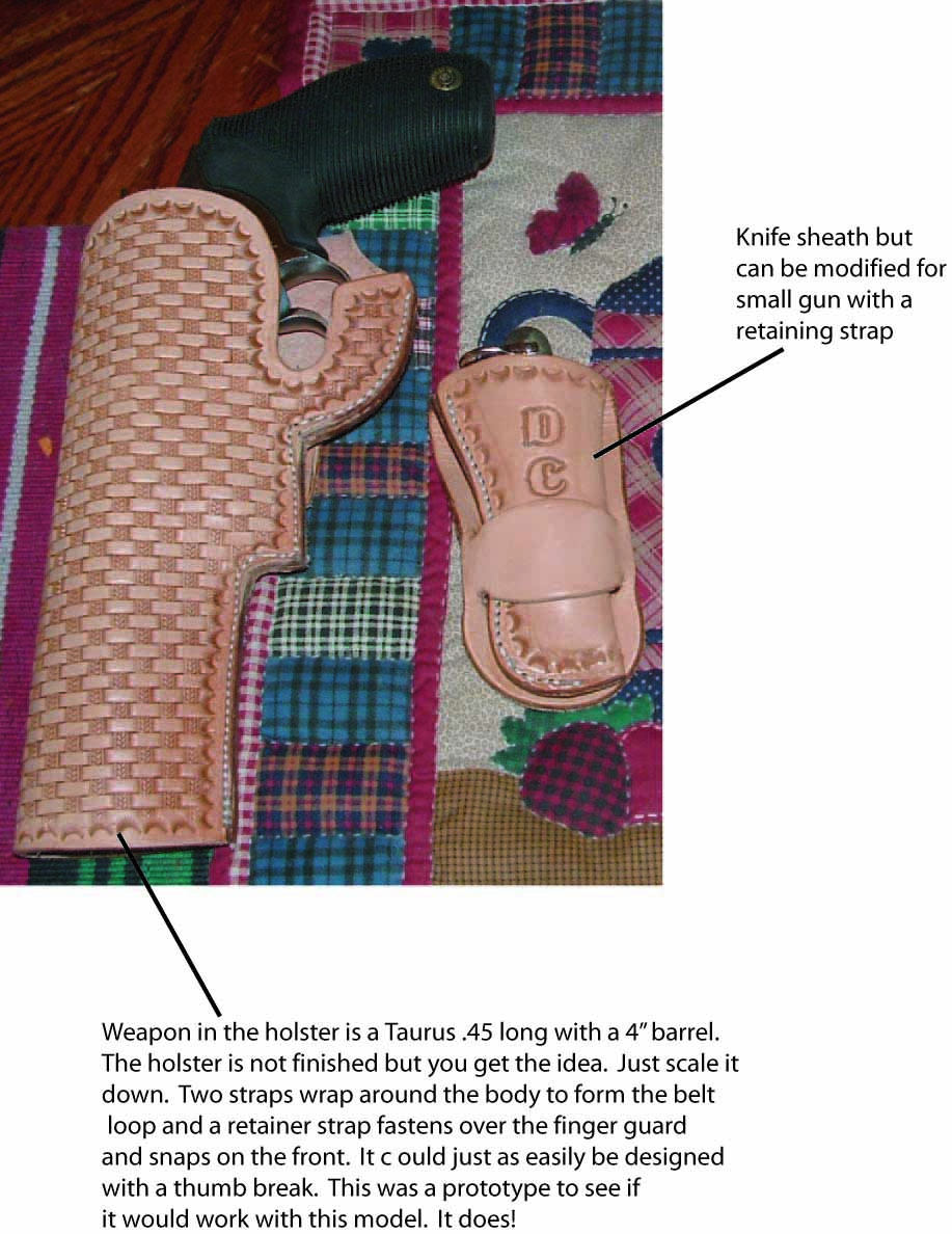

Welcome to the forum and glad you're "getting back on the bike". There are a great bunch of craftsmen & women here with a wealth of knowledge and skill. Show us a picture of the firearm(s). Left hand is easy just flip the pattern over and do everything in your right mind. Is it a 4 1/2" barrel or overall length? What size basketweave do you want? I have access to several that will do the job. With guidance and a little practice and you can make any of them work.

Mike,
Did you make this one?
Indy

That is pretty much what I was thinking of except the mount would be horizontal, crossdraw style, with the hammer forward, and retained, with a small snap similar to many in-the-waistband style nylon holsters, for a fast release.
I have attached from the manufacturer's website, to give perspective, the cylinder is just long enough to contain the average .22 long-rifle cartridge without scraping the end of the bullet.
The magnum adds another 1 1/4" overall
I guess I don't really know what size basketweave I need, but the one on the knife sheath looks pretty much like what I am looking for. I am not real sure what sizes that the Tandy shop here had, but that is about the biggest I would like to go with, and if there were a smaller one it may be even better.

Dok,
What models are those examples? Get back with me at <front_line42@yahoo.com>. I can't upload the file with a couple of holster pictures since it is 2.7MB in .pdf and my .jpg won't load. I'll send it by direct email if that this doesn't work.

Welcome to LW.net! As far as any holster pattern you want to do, regardless of size, you can do it on your computer. If you can get the image, you can resize it however you like, and if it's RH holster....just flip/mirror the image. Almost any graphics/photo program has this ability, and if you don't have one of the high dollar programs, don't worry, there's lots of free ones that will do it.
For the holster design, have you considered something like a horizontal sunglass case that's attached via belt clip? Maybe a PDA/cell case? Not that you should use one of these per se, but what a concealment job that would be! Worn openly and it looks like a pair of sunglasses on your belt. Of course, you'd attach with a loop, instead of a clip.

That is a good looking holster, Hammerhead, a little more open than I am looking for, but very nice. I just got an email from Tandy, I now have a better idea about their basketweave stamps, as they were all together on one screen, I was having a hard time with the stamps all having their own item picture on their website. It don't hurt that they are all half price, (break my heart, lol) on the advertisement, either.

Went by the Tandy store on the way back from the flea market, came out about $60 poorer, but Craft-tool richer, I will probably get started on the first attempt Tuesday or Wednesday. I got the smallest Basketweave stamp they had, I think it is #801, so the stamping may take forever. I had a thought about doing some swivelknife work around the cylinder area, to get a little break from that little stamp, and put some individuality on the holster. The first will be for my Limited Edition NAA gold plated black-powder revolver, so I am hoping that it is at least acceptable, will post some pictures as it progresses, assuming the Kydex comes in Monday.

Thanks alot for your care package in the mailbox this afternoon, I am very sure that I can make it work for my purposes, that was WAY ABOVE AND BEYOND just helping out with a problem on the internet, as soon as you get online, there will be alot of "free advertising" to my various and sundry contacts, internet and through my contacts through the Veteran's hospital, and onpost.

Your welcome. That pattern has become really popular with the pocket knife set. There are a couple of stores in NM near Philmont Scout Ranch that sell as many as I can make during the Summer camping season. Goes good with our Fleur de Leis 1 1/4" concho! If you have any challenges with the assembly I can take some pictures to show the way. Post a picture of what you make with it if you use it. I'd like to see your project.
