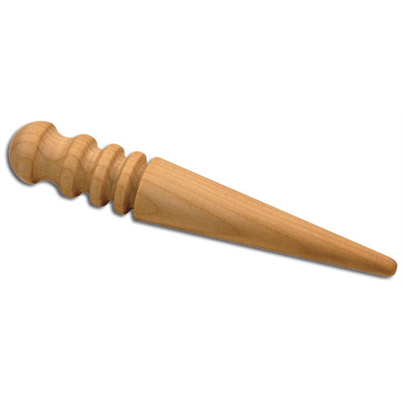

Disclaimer: This is my way of doing it and I am new to leatherworking. There are many other ways to accomplish the same thing and I am sure there are better ways too... but this will get you started and then you can start exploring better ways on your own.
First, you need to sand the edges so that they are straight where they need to be or smoothly curved, which ever the case. Use a sanding block with 120 grit sandpaper for straight lines and outside curves. Use the sand paper by hand or wrapped around some round-stock, for inside curves. Once you have the shape right, finish off with 300 or 320 grit or higher. Make the edge look as good as possible at this point. Keep working until you are convinced that it cannot look any better by further sanding. Do not rely on burnishing to make up for short-cutting on the sanding. The better job that you do on the sanding just makes the burnishing go that much easier and better.
Use a stitch groover to cut a nice groove that runs parallel with the outside edge of your holster. In order to have a good looking, straight stitch groove, you have to have a straight edge on the holster that the guide on the groover can follow. If you have an irregular edge on the holster, then the stitch groove will also be irregular. After grooving, run an overstitch wheel through that groove, for stitch spacing. Get a wheel that is 6 or 7 stitches per inch.
If the leather has not be dyed yet, do it at this time, prior to burnishing the edges. Gum Tragacanth is dye resistant, so once the edges are burnished with it, you cannot successfully dye the edges.
Get some Gum Tragacanth and a burnishing tool. I prefer the wooden tool sold by Tandy (see attached pic). Using a Q-tip, apply some Gum Tragacanth to 2 or 3 inches of the sanded edge. Apply just enough to wet it, You don't want it running down the side. Let it soak in for a few seconds, then rub the burnishing tool rapidly, back and forth on the edge. Rub hard and fast. You want heat and pressure. As the leather starts to heat up and smooth down, the Gum will be absorbed and start to dry. You will begin to hear a squeeking or chirpping sound. When you hear this, you know that you are doing it correctly. Continue for a few more seconds and watch the leather get smooth and shiny. That spot is done. Apply the Gum to the next 2 or 3 inches and continue until your project is done. BTW, you can go back over an area a second time if necessary.
Good luck,
Nick
