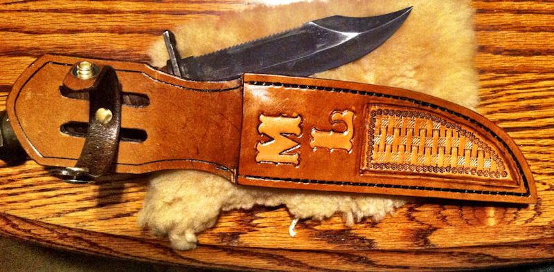

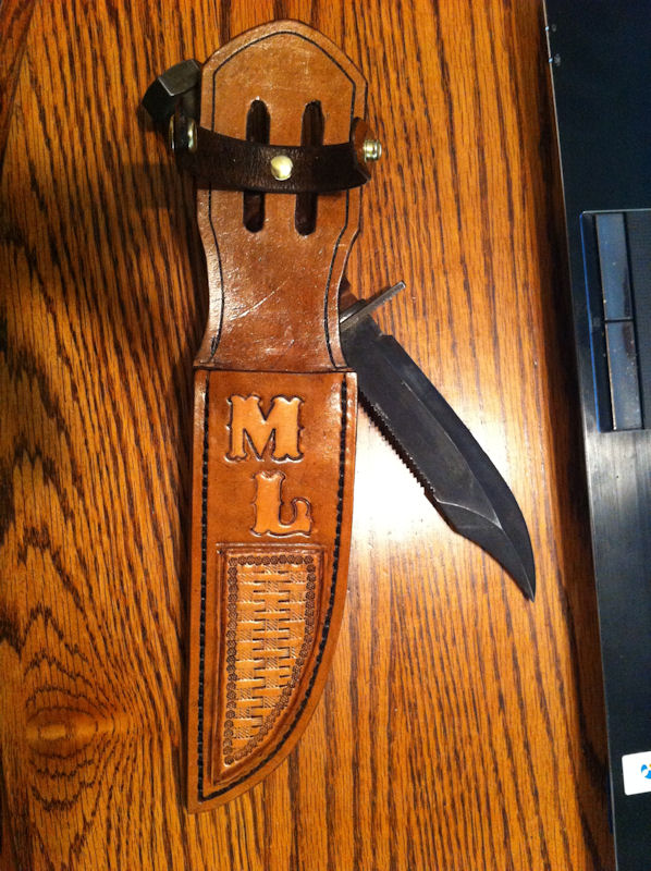

There are many ways to do things. I have to say that in my opinion a rivet has no place on a knife sheath. THey can dull the blade and just seem cheap. Yes they are fast but some times fast seems cheap. When you hand sew a sheath, or even machine sew it looks better and has that hand crafted look that a rivet will never have.
Below is the second sheath I did. I am proud because it was good for where I was in my skill level. The only rivet is the one that holds the strap to the sheath. its 8oz with an 8oz welt. It's not a purchased kit although it looks similar to the Tandy kit. I noticed that after it was finished. If you look at the pattern you will see part C&D is the top piece and also the welt. The welt is only 3/8th of an inch. you just need enough to be wider than your stitch line.
If you use rivets its your decision. I just feel it will look better without them and look more professional. This was not meant to put down anyone that does use rivets. It is just my personal opinion.
