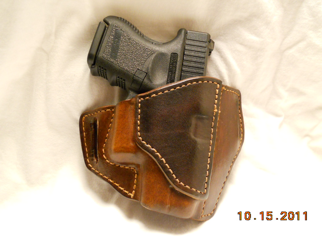

Thought I would show some stuff Ive put together since gettin a good deal on a very lightly used Boss.
Really lovin this machine.
IWB for Glock 26/27
post-17161-047301300 1318652756_thumb.jp
post-17161-090176500 1318652821_thumb.jp
IWB for 4 1/4 1911
post-17161-012242000 1318652874_thumb.jp
post-17161-000357800 1318652907_thumb.jp
Pancake for a Glock 26/27
post-17161-054057600 1318653042_thumb.jp
Thanks for looking.
CJ
