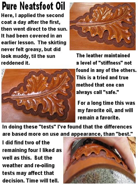

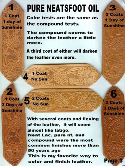

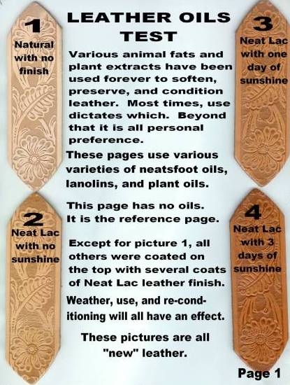

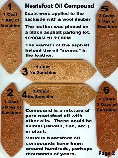

Hilly Posted June 18, 2008 Report Posted June 18, 2008 I'm curious as to just how tanned a piece of sun tanned leather will get? Will it achieve a saddle tan color? How long does it take? I'm sort of experimenting right now with a project. I've had it out in full sun for about the last 6 hours, and I've misted it very lightly with plain water several times during the day. So far, it's gone from a pasty looking VERY pale piece of leather, to almost the color of the brown surrounding the "Leatherworker!Net" logo. At the end of the day, I will post a photo of the color change you can get from one day in the sun. If I can get a decent medium saddle tan color, I think I will just stop trying to achieve that color using dyes and use the sun, followed by a light coat of pure neetsfoot. A more "green" approach, if you will. Does anyone have an example of just how tan a piece of leather can get from pure sunshine? Can you post a photo of it, next to a piece of pale, un-suntanned leather? Quote
Hilly Posted June 18, 2008 Author Report Posted June 18, 2008 (edited) I'm curious as to just how tanned a piece of sun tanned leather will get? Will it achieve a saddle tan color? How long does it take?I'm sort of experimenting right now with a project. I've had it out in full sun for about the last 6 hours, and I've misted it very lightly with plain water several times during the day. So far, it's gone from a pasty looking VERY pale piece of leather, to almost the color of the brown surrounding the "Leatherworker!Net" logo. At the end of the day, I will post a photo of the color change you can get from one day in the sun. If I can get a decent medium saddle tan color, I think I will just stop trying to achieve that color using dyes and use the sun, followed by a light coat of pure neetsfoot. A more "green" approach, if you will. Does anyone have an example of just how tan a piece of leather can get from pure sunshine? Can you post a photo of it, next to a piece of pale, un-suntanned leather? This is after 7 hours of full sun. These are from the same piece of leather. I did not expect to see this much difference. Tomorrow if the sun shines again, I'll put it out for another 7 hours and see what happens. Edited June 18, 2008 by Hilly Quote
Contributing Member TwinOaks Posted June 19, 2008 Contributing Member Report Posted June 19, 2008 Hi Hilly, I left a piece of test scrap on the porch a week or so ago, and it's significantly darker. There's a little swath of it that didn't get sun, and the difference is even more pronounced than what your pic shows. I don't hesitate to think you can achieve at least 5 shades darker. Of course, this will depend on the leather itself, and how much tannins is got at the tannery, but you knew that. I do really like the effect though, it just looks better than an applied tan. Quote Mike DeLoach Esse Quam Videri (Be rather than Seem) "Don't learn the tricks of the trade.....Learn the trade." "Teach what you know......Learn what you don't." LEATHER ARTISAN'S DIGITAL GUILD on Facebook.
Elton Joorisity Posted June 19, 2008 Report Posted June 19, 2008 Y'all oughta try oiling it first and then giving it a sun tan. Quote "If you see your stirrups slap together above the saddle horn, you're probably bucked off" Dave Stamey, The Bronc Ballet
Hilly Posted June 19, 2008 Author Report Posted June 19, 2008 Y'all oughta try oiling it first and then giving it a sun tan. I was thinking about doing that. Have you done this? How did it turn out? Quote
Members dbarleather Posted June 19, 2008 Members Report Posted June 19, 2008 IMO oil and sun is the easiest and most beautiful way to add color to your leather. Quote http://www.dbarleather.com
Ian Posted June 19, 2008 Report Posted June 19, 2008 I have never tried letting the leather darken naturally, but I was wondering on something like a saddlebag, you'd get a light area under the flap 'where the sun don't shine' wouldn't you? Quote http://blackcanyonleather.net/
Ambassador abn Posted June 19, 2008 Ambassador Report Posted June 19, 2008 I'm certainly not an expert on this topic, but I will say that I put olive oil (and no dye) on one of the keyfobs I made a few years back. Over time, the color has gone from pale to tan to a deep, rich brown -- and darker than I really like. It's certainly not tan anymore. Nowadays, I use Eco-Flo Ranger Tan when I'm going for a tan finish. The good thing about using a dye is that it locks in the color just the way you want it. You don't have to worry about a project that's exposed to sunlight getting darker and darker over time... -Alex Quote
Hilly Posted June 19, 2008 Author Report Posted June 19, 2008 Once I get my project to the degree of "tan-ness" I like, will sealing it with supersheen or tankote keep it from tanning further? Quote
Ambassador abn Posted June 19, 2008 Ambassador Report Posted June 19, 2008 I don't think so. My project was sealed with Satin Shene and the sun goes right through it. Maybe there's someone that knows of a different finish that might work? Quote
